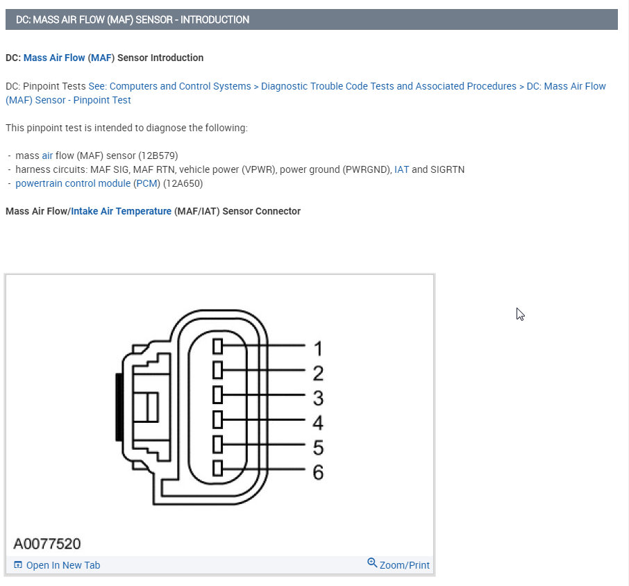

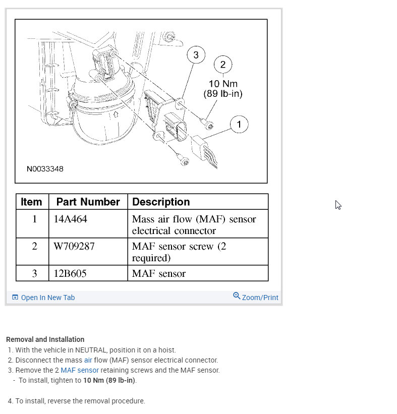

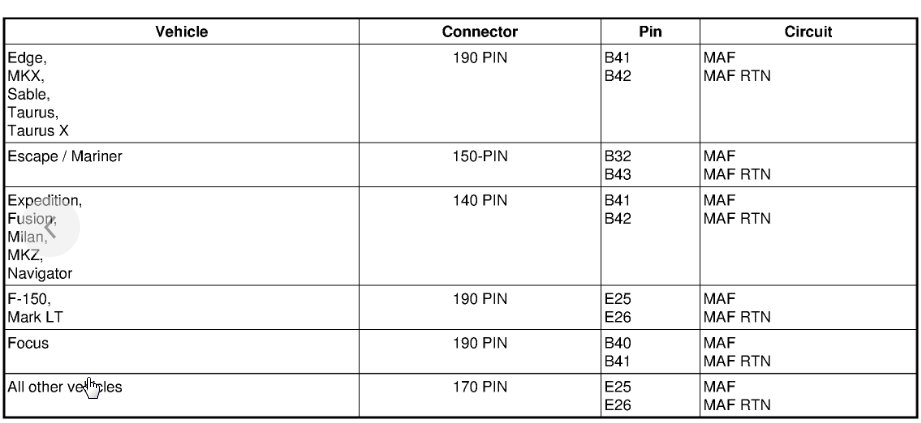

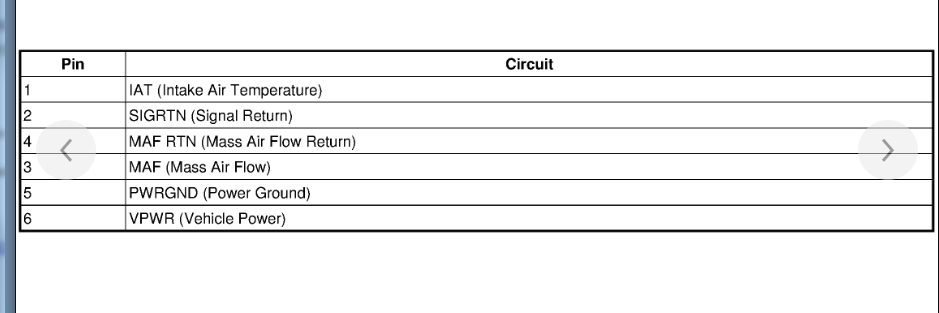

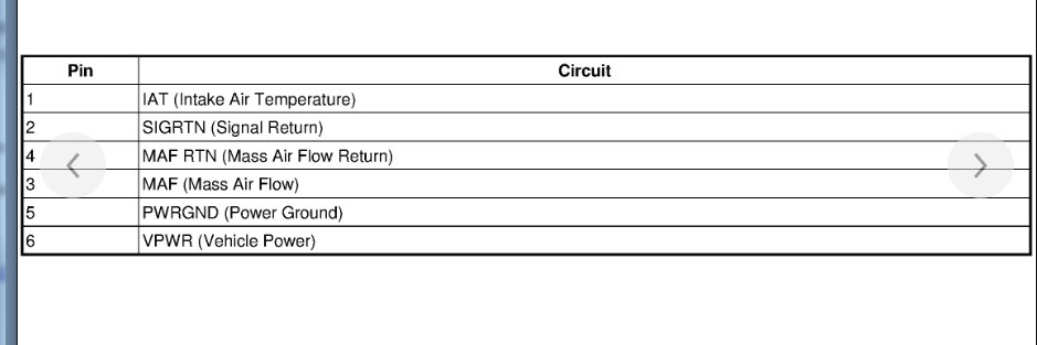

I attached a couple guides on low power and then one on MAF sensors as this sounds the issue if it is not fuel related.
https://www.2carpros.com/articles/engine-has-low-power-output
https://www.2carpros.com/articles/mass-air-flow-service
