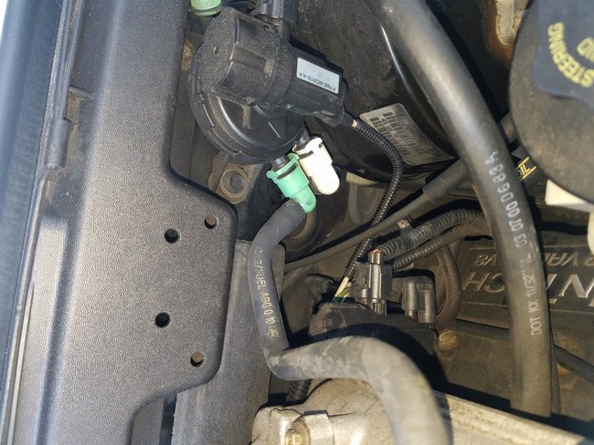

But recently began stalling when I stop and then get going at a stop sign or right turn.
Sometimes it will almost stall but the engine will surge before over accelerating to compensate.
So far I have cleaned throttle body; IACV, MAF and ran some fuel injector cleaners.
I have also checked the elbows on the PCV hoses near the grommets.
It always starts right back up once I put it in neutral. Any ideas on what I should check next?
Also, I have no dtc codes.

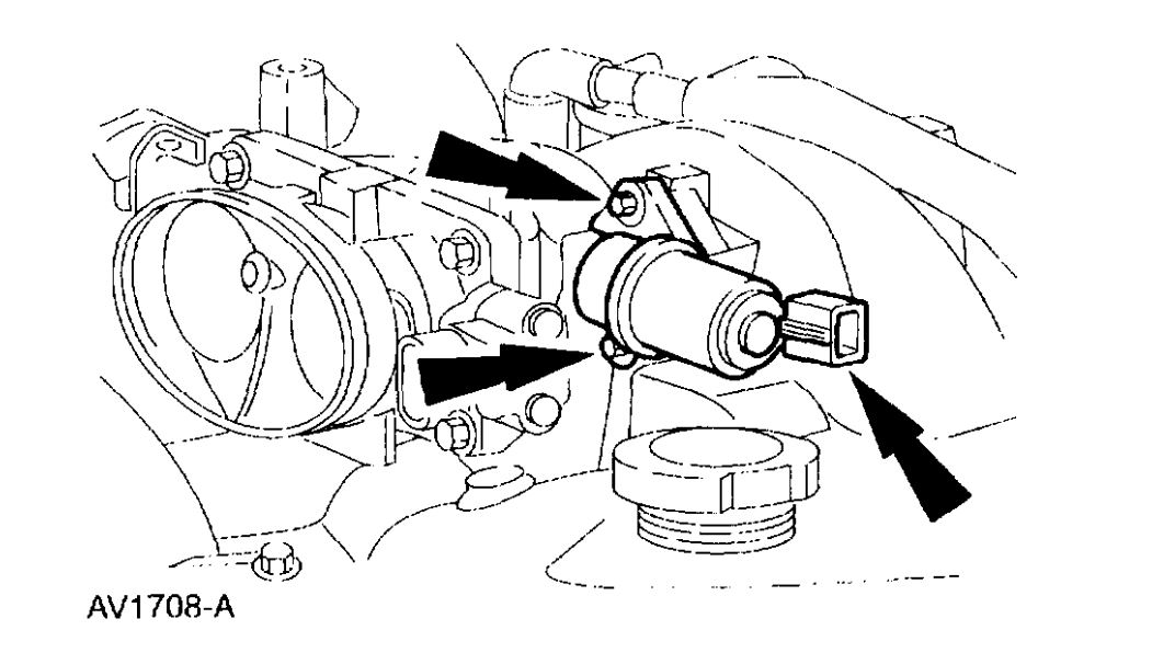

The IAC valve is the common issue and it cannot be cleaned. The area that is carbon-ed up is not accessible to clean. That must be replaced if deemed bad.
After you replace the valve, disconnect the wires to it and let the engine run. It should idle at 500 RPM. Once you have adjusted the idle to that spec, then hook up the IAC and the speed should increase.

With the engine idling, remove the connector from the valve and see if it stalls.
Tuesday, May 15th, 2018 AT 11:16 AM
BUSINESSFRED
  • 93 POSTS
Okay, it did not stall. Does this mean the issue is elsewhere?
It settled at 500 rpm just like you said.
Tuesday, May 15th, 2018 AT 11:19 AM
Yes it does. Let me check some things.

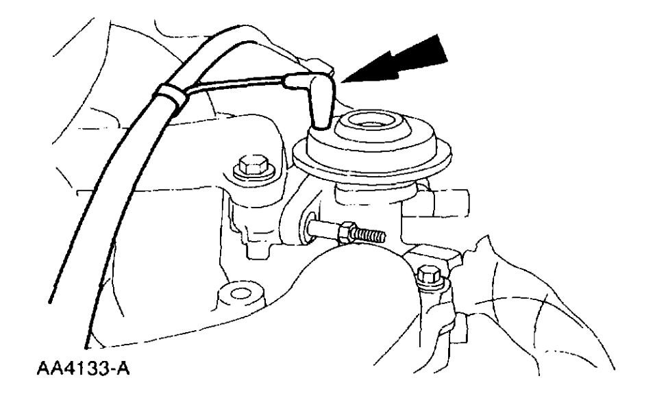

The only other thing I found was the EGR valve. If it does not close fast enough coming to idle, it can cause stalling.
Do you have a scan tool to monitor the EGR system?
Tuesday, May 15th, 2018 AT 1:29 PM
BUSINESSFRED
  • 93 POSTS
I do not have a scanner with live data.
Is the EGR valve the one with the single hose port against the firewall?
Or the one with two hose ports directly on the intake?
Can I clean this valve or is this a replacement only part?
Tuesday, May 15th, 2018 AT 1:50 PM
Single hose. Try removing the hose and driving it and see if it is any better.
No, it cannot be cleaned.

2. Disconnect the Exhaust Gas Recirculation (EGR) valve vacuum line.
ImageZoom/Print
