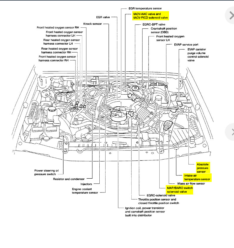

Truck will stall at a red light
PRICEC
  • 2000 NISSAN FRONTIER
  • 3.3L
  • V6
  • 4WD
  • 255,000 MILES
Cleaned MAF sensor ran good for a few minutes and then shut off. Any ideas?
Monday, July 29th, 2019 AT 1:29 PM
Hi Pricec,
If cleaning the MAF made a difference, you may want to do the same to the intake air temp sensor and ambient air temp sensor.

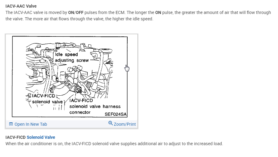

If that does not help then please refer to the attached guide. This will walk you through the basics of testing for stalling at idle.
I would start with the IACV. See attached.
Let me know what you find. Thanks
