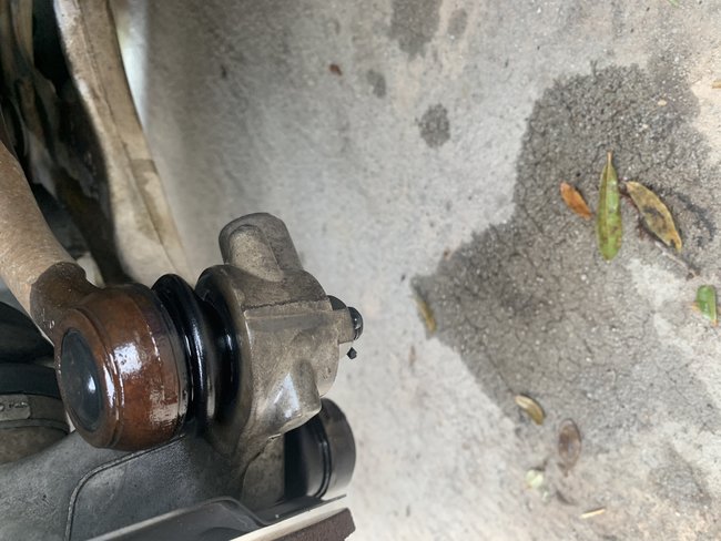

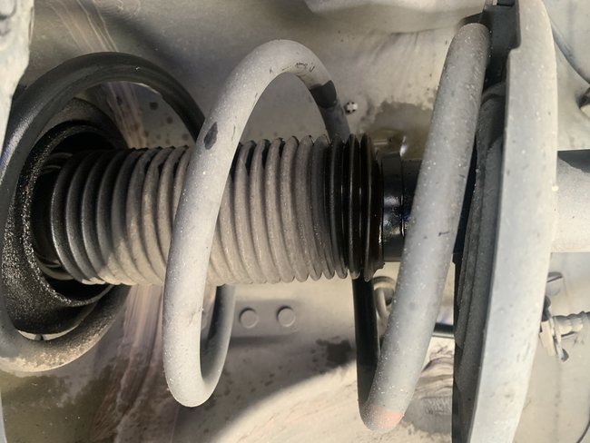

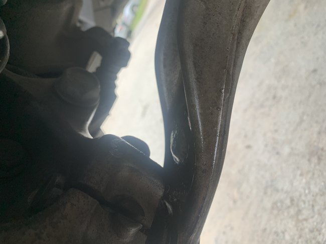

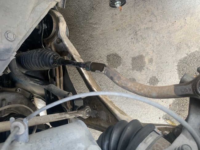

My car has been making a squeaky noise when I get inside of it as well as when I press the gas. It only seems to make the noise when I’m accelerating. It is still slightly noticeable when my foot is off the gas, and it gets noisy again when braking. Although I am due for a brake change, I know the difference in sound it makes when the clips rub on the rotor, so it is not coming from the brakes. I will add a couple of pictures and some videos of the sound. I added a little w-40 to some parts to try to make the noise go away but it is still apparent.

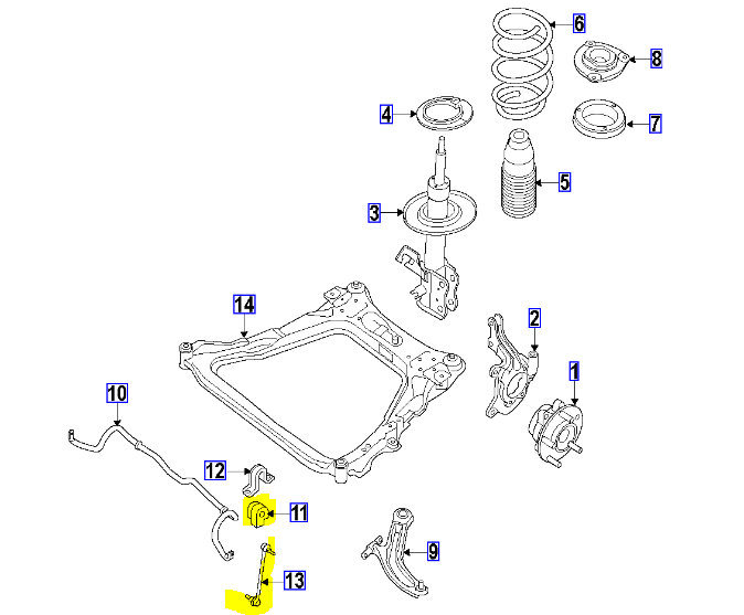

I watched the video and certainly heard it. Is there anything that changes to volume or pitch of the sound? For example, if you make a turn or hit a dip in the road? You indicated you could hear it when you get in the vehicle which makes me think bushing. If you bounce the front of the vehicle, can you reproduce the sound? Does it change in intensity with speed? Have you checked the stabilizer pins and bushings? Take a look at the attached pic below. I highlighted the stabilizer pin and bushing for one side.
Sorry for so many questions. I'm just trying to get a solid understanding.
See pic below.

Thank you for the timely response. To answer your questions, the sound changes in intensity, especially on bumpy roads and bumps. It is also louder when I barely begin to accelerate the car. Also yes, if I bounce the front of the vehicle, it also makes the sound. And yes, I have checked the bushings, what would you recommend?

If the sway bar bushings and stabilizer links are good, then we need to assume it is a shock or ball joint noise.
If possible, have a helper try to determine approximately where the sound comes from when you bounce it. Also, you may want to lift one front wheel at a time about 4 inches off the ground and place a pry bar between the tire and the ground. Pry up and down to see if there is play in a ball joint.

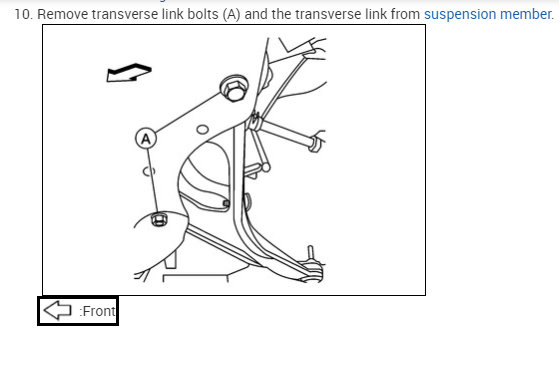

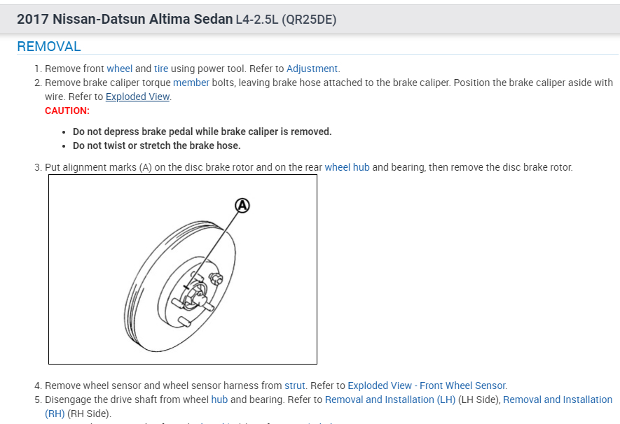

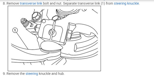

It’s okay you’ve been a huge help so far. I would like some tips to replace the lower control arm. For example, where is the best place to buy replacement parts that are affordable but still great quality? Also, a diagram of how to replace it would be nice too. Thank you again and you will be hearing from me again just in case the problem isn’t fixed.

As far as getting replacement parts, I would simply go to a nationally recognized parts store and purchase their brand with a lifetime warranty. Rockauto usually has great prices, but the warranty isn't lifetime. If you decide to get it there, let me know. I can give you my 5% off code.

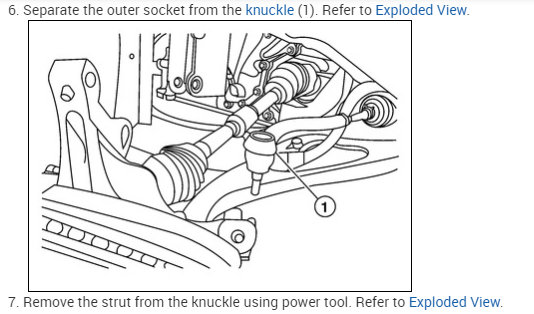

I attached the directions below that I could find. Before you start this, spray down the bolts with a good penetrating fluid a day in advance so it can work in and make things easier to take apart.
Let me know how this works out for you.
