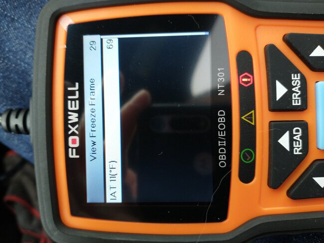

So, I got my live scan tool today. It came later in the day, so I didn't have much time to mess with it. I did get a confirmation of the cylinder one misfire and went into the live data a bit. Now you're talking about the freeze frame. Does that happen when you have it in live scan mode, and does it just freeze frame all the info when the fault happens?
Sunday, March 12th, 2023 AT 4:30 PM
  • 110,192 POSTS
It will automatically save the freeze frame data when the issue occurs. The scan tool doesn't even need to be connected. If the scan tool you have does retrieve freeze frame info, you should be able to check it now.
Sunday, March 12th, 2023 AT 6:49 PM
JBABS1278
  • 31 POSTS

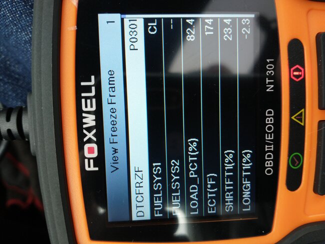

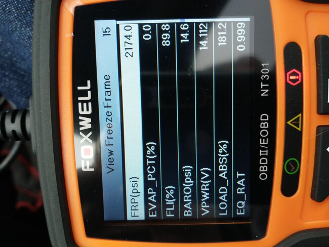

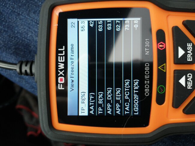

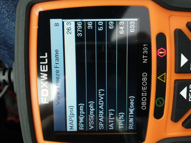

So, this is actually the second freeze frame because I erased the codes and had to go and get the engine light to come on again. Sorry for doing it this way for some reason I can't print the freeze frame data from the PC.
They are in no particular order.

  • 110,192 POSTS
I need to know something. Two things stick out to me, the IAT and STFT. (Intake air temperature and short-term fuel trim).
The STFT is high. In a perfect world, it would stay at 0%, but yours is at 23.4% which indicates the computer is trying to add fuel. Under normal conditions, the trims should stay between -10% and +10%. This can be the result of a weak fuel pump or an engine vacuum leak. However, the IAT makes me question it. The IAT temperature indicates 69F. I'm not sure where you are located, but that should be approximate under-hood temperatures. If you are in a very cold climate, I guess it could be okay.
I need you to check one more thing. See what the engine coolant temperature sensor indicates. It should be around 5 degrees difference. If it isn't, I suspect the IAT is failing.
Monday, March 13th, 2023 AT 8:44 PM

I believe what you're looking for is the ECT, same thing right? It shows 174 on the freeze frame data. And if it matters, I took it for a ride and watched the STFT and it varied about 7 points max either side of 0, and mostly around 2 points. It also showed similar IAT temperature.

The fuel trims sound good then. When you say the IAC showed similar readings, are you referring to what I read on the pic or did you get a reading similar to the ECT? And yes, the ECT is the engine coolant temperature sensor.
If the IAT was similar to the ECT, I wonder why it was off on the scan tool originally. The engine was at operating temperature when checked, correct?
Tuesday, March 14th, 2023 AT 7:14 PM
JBABS1278
  • 31 POSTS
No sorry, meant to say it was similar to the pic, in the 70s. And yes, it was at operating temperature.
Tuesday, March 14th, 2023 AT 7:27 PM

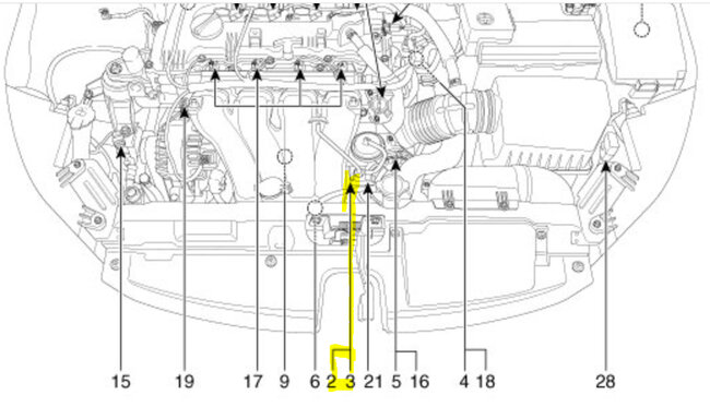

  • 110,192 POSTS
The IAT is likely faulty. It should be showing a similar temperature as the ECT or under-hood temperature.
The IAT is integral to the manifold absolute pressure sensor (MAP). I attached a pic below showing its location.
Check the wiring to it, make sure the connector is in good condition, and I would recommend removing it for inspection. There shouldn't be that big of variance in the signals. Five- or ten-degrees difference I could suspect. This is way beyond that point.

JBABS1278
  • 31 POSTS
So found it think. This appears to be part of the MAP sensor or boost pressure sensor on turbo engines, right? That is what I'm seeing online anyway. I disconnected the harness and looked in perfect condition.

  • 110,192 POSTS
Yes, that appears to be correct. The IAT is integral to the MAP. Also, it can be referred to as a boost pressure sensor on a turbocharged engine.
