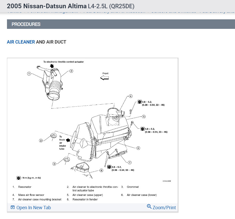

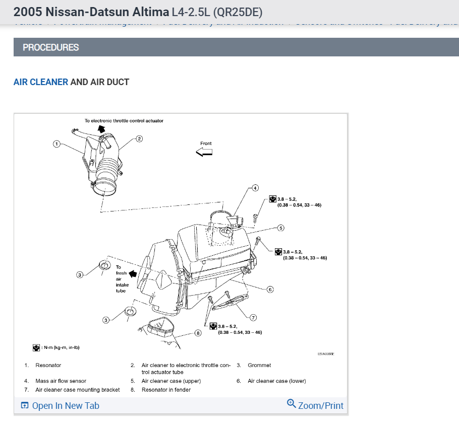

After using a lot of starting fluid my car began to sputter. And loses power while driving.

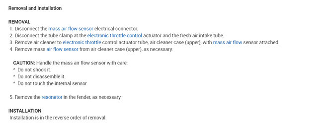

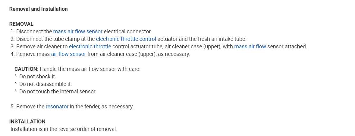

It sounds like you may have burned out the MAF sensor, but we should run the codes to see what comes up.
This guide can help:
This guide can help as well:
https://www.2carpros.com/articles/step-by-step-guide-on-what-causes-an-automobile-to-sputter-and
Here is how to change out the MAF sensor in case you need it. Check out the images (below). Please let us know what happens.
