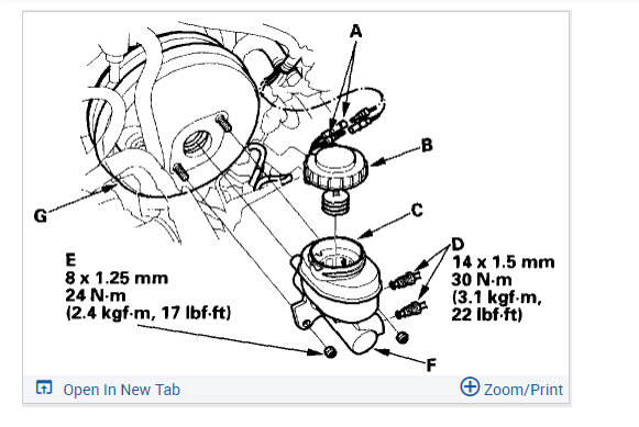

If the brake pedal is going to the floor, there is a good chance the master cylinder has failed as a result of the fluid leaking.
Over time, the plungers in the MC ride the same distance. As a result, dirt and corrosion can develop in the sections not used. If the pedal suddenly goes to the floor as a result of a (in this case) a leak at the hose/banjo fitting, it could have damaged the plungers.
Try this: With the engine off, pump up the brakes until you get a firm pedal. Then, hold pressure on the pedal and see if it slowly goes to the floor. If it does, replace the MC.

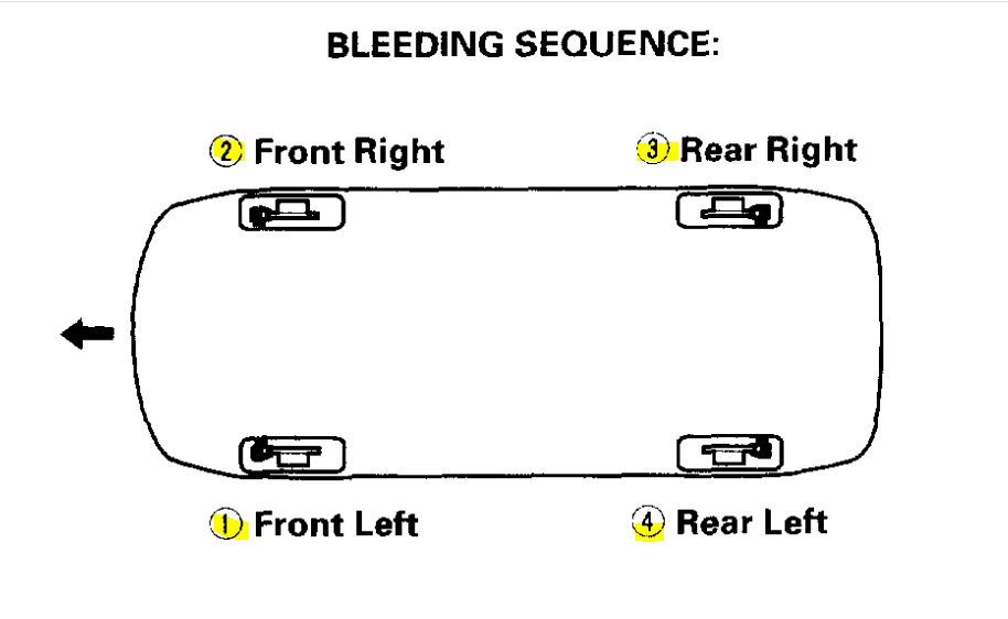

Also, take a look at the attached pic for bleed sequence. Make sure you do it in that order.
See pic below.

I followed the recommended sequence, but as the vehicle was an Australian-release Honda MDX, I had to start from the front right. I selected the US equivalent Acura MDX as the option was not available while feeding the vehicle details.
I conducted the test you suggested and found that the pedal was very firm at the first 1/4th travel (with the engine off) and it did not go all the way to the floor even with full force. I also tested the pedal's firmness before connecting the lines to the MC during installation, plugging the out ports and pumping the brakes. The pedal remained very firm even when the engine was on.

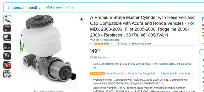

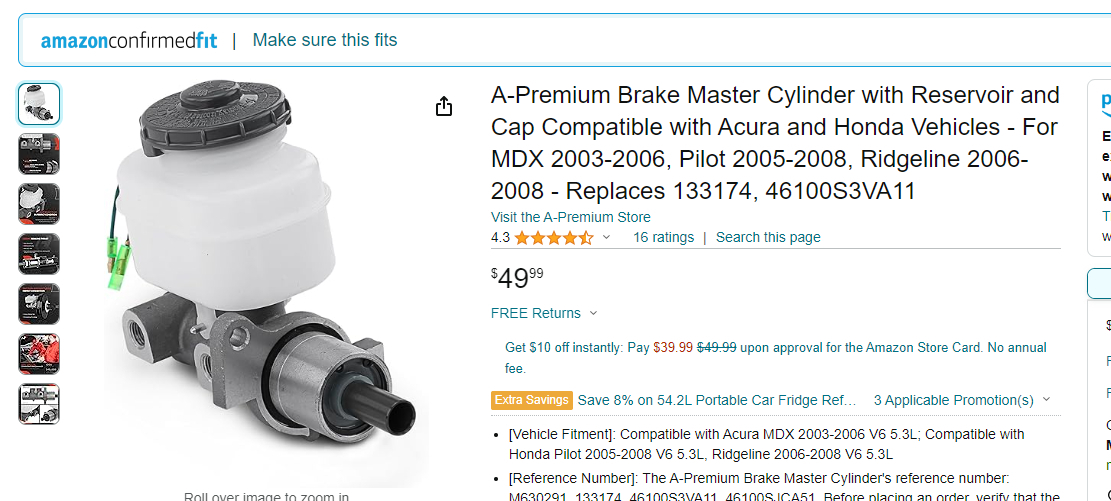

Yes, that can cause damage. I'm surprised you can't find a new one. Take a look at the pic below. That is on Amazon. Does that appear to be the correct one?
Se pic below.

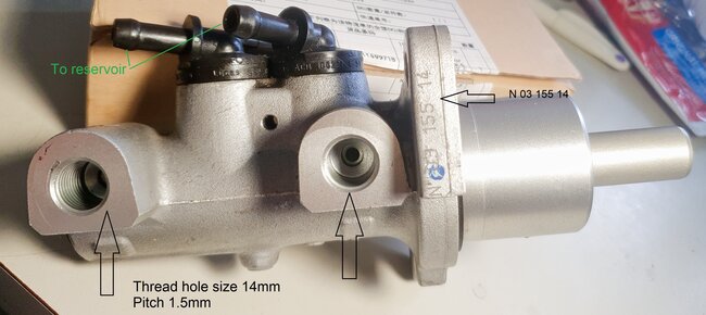

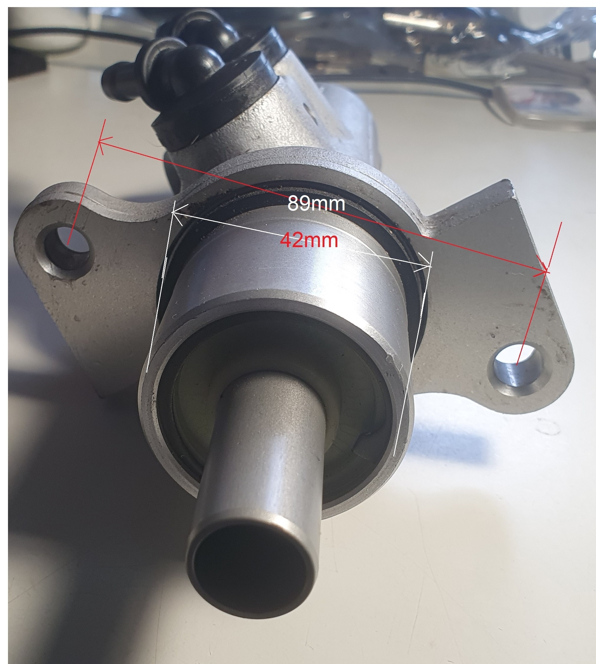

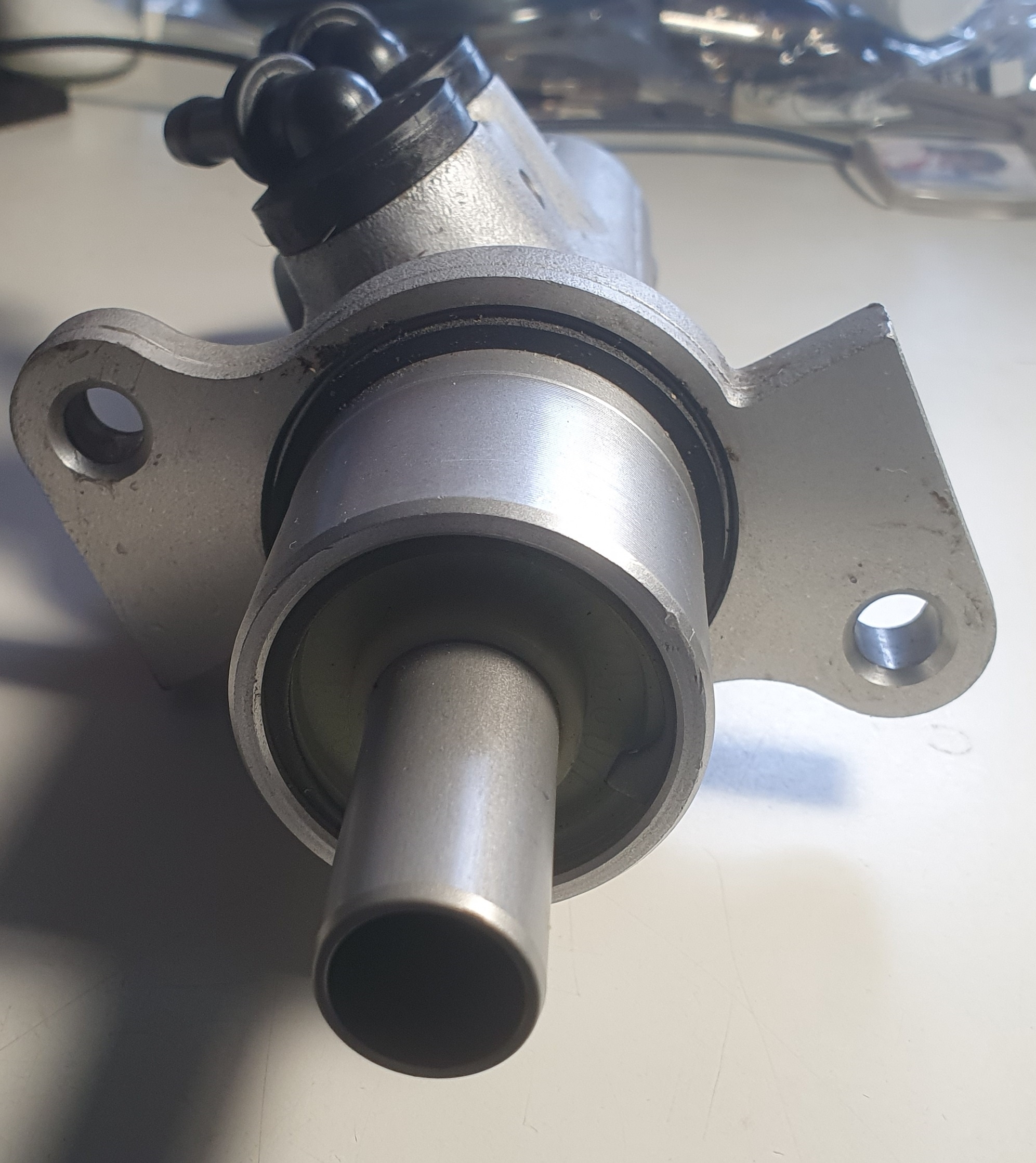

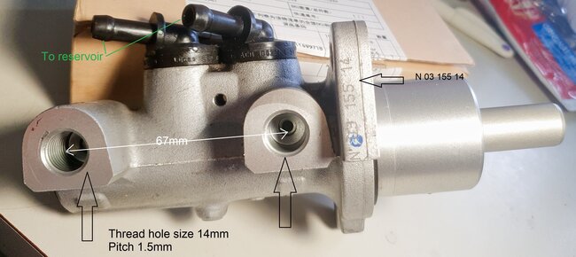

Thank you for sending me the picture. My part number is 46110s3va11, while the Acura MDX part number is 46100s3va11. I noticed that the reservoir in the Acura MDX is sitting on the master cylinder, while in the Honda MDX, it is connected with hoses. In the Honda MDX, there are two plastic connectors on the rubber grommets that connect the hoses. Both MCs have the same outlet size, which is 14x1.5mm. However, I am unsure if all other specifications match. If they do match and the hose connectors can be attached to the rubber grommets, I would be interested in purchasing the Acura MDX master cylinder. The Honda MC appears difficult to dissemble and I couldn't find the bore diameter. I understand that the bore diameter in Acura MDX is 1.06"
I have attached images of my current master cylinder for reference. I would appreciate any information you can provide on this matter.

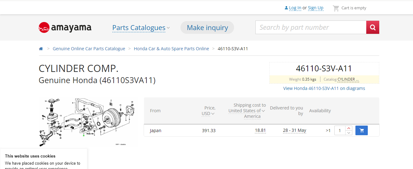

  • 110,194 POSTS
I've never seen an MDX tagged as a Honda. I thought they all had the Acura name. Are you located in the US?
I did a quick google search on the part number and found one. See pic below. Is that what you are looking for?
See pic below.
Tuesday, May 14th, 2024 AT 6:09 PM
RAJ SUNDAR
  • 42 POSTS
Hi Joe,
That is the correct part, but it's quite expensive, costing around AUD 641.00 including postage, while the Acura one is around AUD 100. I was able to dismantle the master cylinder of the Honda MDX and found that the bore diameter is 1.06", which is the same as that of the Acura MDX master cylinder. The plastic connectors were also detachable. I need to confirm the following three things about the Acura:
1) The outer diameter of the cylindrical portion that enters the booster is 43mm or less.
2) The distance between the center of the mounting holes is 89mm.
3) The distance between the center of the outlets is 67mm.
I am currently seeking the specifications of the Acura MDX MC. I will update you once everything is confirmed.

I have attached pictures with measurements marked for your review.

As far as the specifications you are requesting are concerned, that isn't something my manuals provide. If you are able to locate the manufacturer of the MC, that information may be available. I feel bad I don't have it. And yes, it was an Acura I checked in my manuals.
