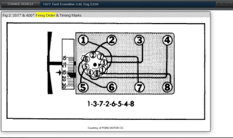

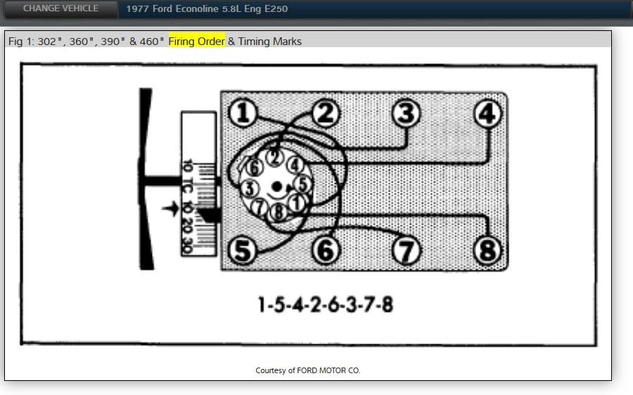

My van, with a 351w, engine. So far you gentlemen have helped me. My van was not running, it sat for a period, so we did a full tune up, new plugs, wires, cap and rotor, etc. It cranks just fine, but still would not start. I checked what I could and found out that my buddy had not hooked the plug wires to the correct number's. So I looked up the correct firing order and reconnected the wires. I went to start the van and it would not start, now it was spitting gas out the top of the carburetor. I know I cannot be that stupid to connect them wrong. Or could I. Could you lead me in the right direction. And the carburetor is a new Edelbrock #1406. I am so close to getting itto run again.

Check firing order as per your engine.

Sorry about the multi pictures. I do not know how that happened. Just check the two firing orders and check against your engine.

Ok, hopefully this will sort you out.
