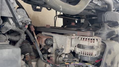

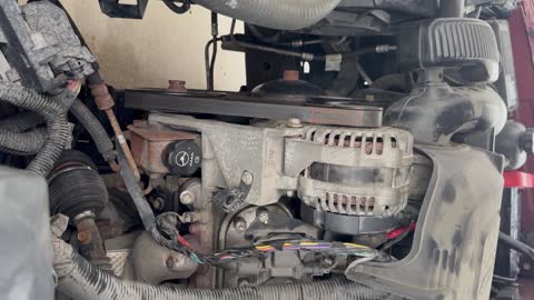

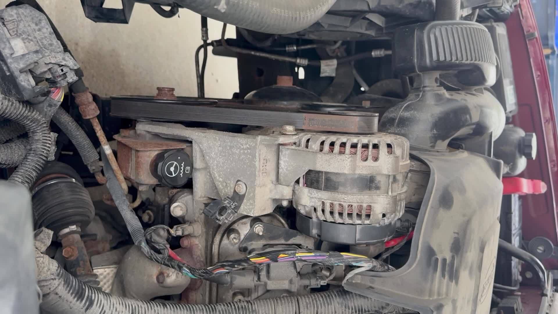

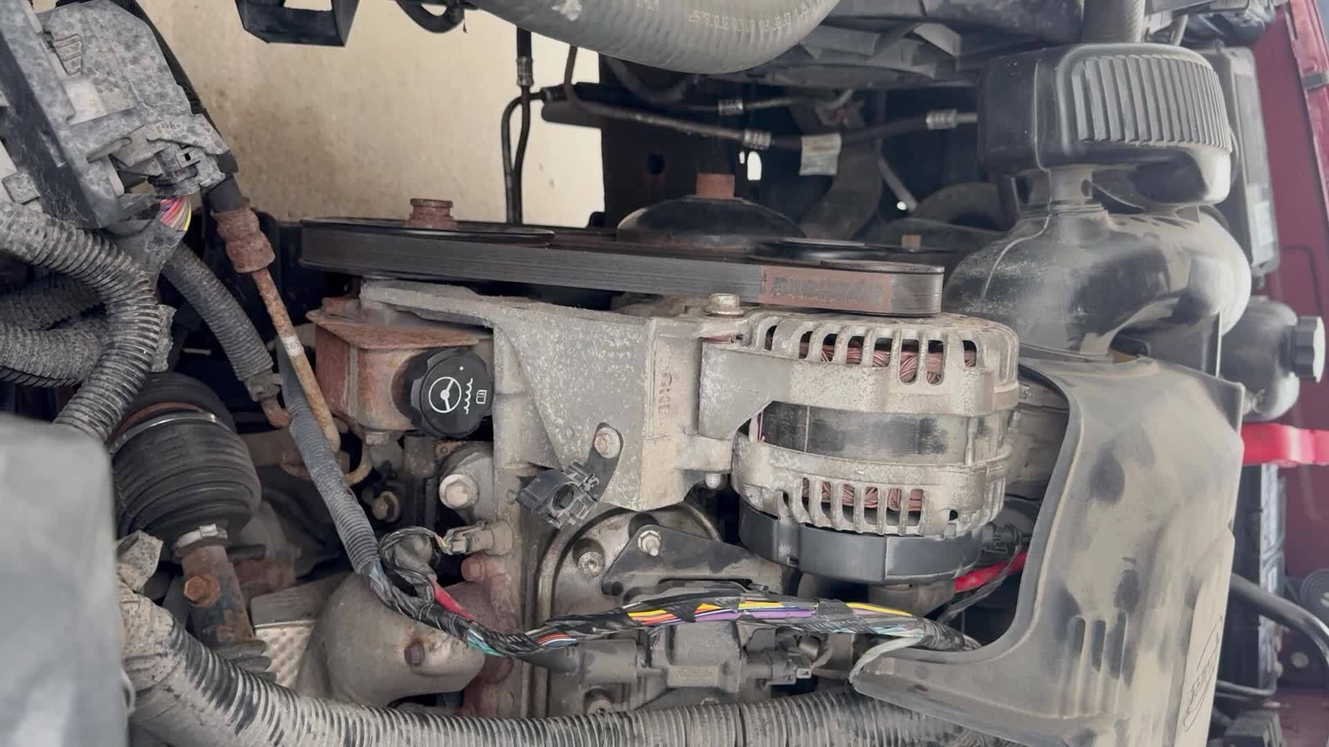

My vehicle lost power and engine light came one throwing a code for the timing chain. Since then, we have replaced timing chain, oil pump, starter, battery, thermostat, and fluids. We went to start it, and it just spins then stops. Check engine light is not on! We plan to change crankshaft and camshaft sensors next. We are baffled and need some sort of help with possible repair advice.

I can help you, but can I ask that you upload a short video of what the engine is going? Is it a hard stop, does the engine start and then stop? Where does the noise seem to be coming from? You can upload it here with your response. We need to hear the noise, so we know which direction to go to help you fix the car. It takes time to upload so please be patient.

The engine doesn’t start but the belts are all working. This time it did a small quick backfire around the cover.

  • 54,503 POSTS
Yep, that helped, the engine has no compression. So, the timing chain marks must have been off, or the valve was bent when the timing chain let go. It might be time for a rebuilt/used engine, sorry about that. :/ here is a video series that can help you tear down and repair the engine if you want to do the job yourself:
