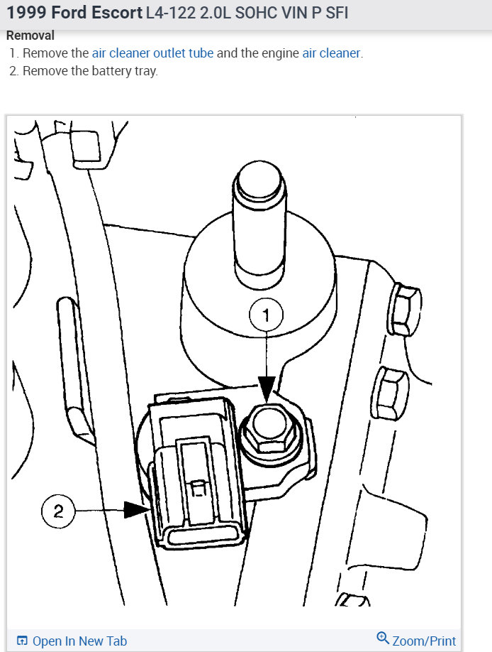

I have the car listed above zx2 and the speedometer/odometer quit working.

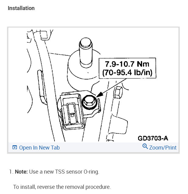

Most of the time when this happens is because the vehicle speed sensor (VSS) has gone out. here is the location so you can replace it to fix the problem. Check out the diagrams (below). Please let us know what happens.
