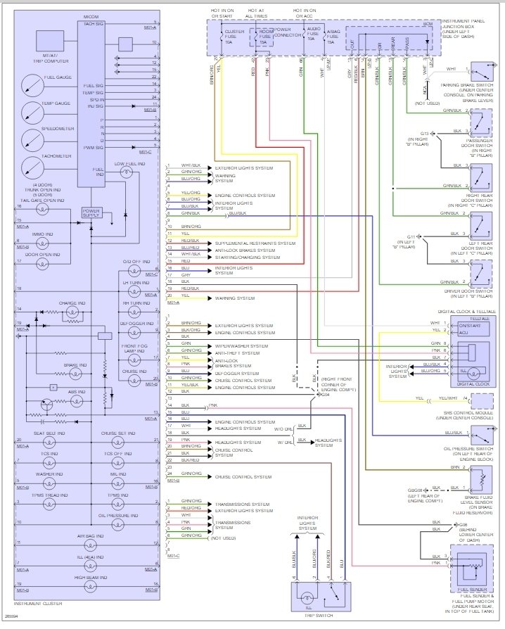

It looks like the speedo is feed by the cruise controller, this unit maybe heating up and then failing, I wanted to ask the the VSS still show a reading when the speedo is not working? If so the cruise unit could be at fault, here is a diagram.
+2

When the mechanic plugged in his reader and drove the vehicle, he could see the speed reported on his device even though the speedometer was not working. This, he says, means the VSS is working properly. I saw another post saying that there is a short in the signal wire that goes from the speed sensor to the back of the cluster (through the firewall). Apparently when they cut that signal wire and replaced it, the speedometer worked properly again. Problem is, I have no idea where that wire is or how to replace it through the firewall.

  • 55,538 POSTS
Thanks saturntech9,
It looks like the speedo feed goes through the cruise control unit, grn/org wire, I would try a new wire locate it from the sensor to the cruise control unit first, or replace the cruise control unit.

SATURNTECH9
  • 30,869 POSTS
Or get some of those bullet style male female connectors so you can bypass the cruise control module to see if it's bad. Before investing in a cruise module.
