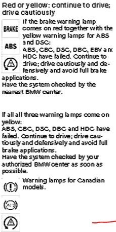

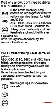

Here is another thing that will help us along. The color the lights are lighting up. I just attached the chart for that.In this system the instrument cluster has a module for the systems that handles all of what you are having trouble with. It's probably the issue, Please get me the codes you got from scanning it to.
But I'm thinking it the integrated instrument cluster module that is your problem. It's the only place all those circuits or systems are run together. I will look for a test for bench testing it or maybe the scanner will pick that up.

The color of the lights is amber. I have to borrow the tablet again to get the codes but I do remember that it stated that neither of the rear sensors actually read (all four wheel sensors have been replaced with new).

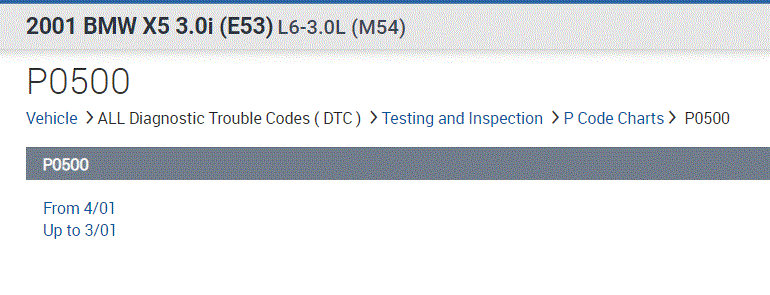

I finally got a chance to read the codes again and they are as follows: BD electronic brake balancer. transmission 149.. ABS 31 , 104, 30.. engine 214, 190, 191 and 68.
I know the o2 sensors need replaced but don’t think those effect the speedometer and ABS.
Sep 6, 2020 at 7:55 AM
  • CAR REPAIR CONTRIBUTOR
  • 110,193 POSTS
Okay, the codes you provided are mostly engine related, but the one that stands out to me is the 214 which is related to speed sensor A. However, I need to know the build date of your vehicle. See pic 1. Also, note that the code translates to a P0500.

The build date is 09/01.
