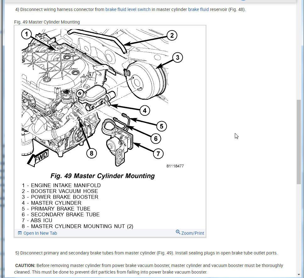

Brake Master cylinder is bad
KATHLEEN D BOOTH
MEMBER
2006 CHRYSLER PACIFICA
4WD
AUTOMATIC
181,000 MILES
I did looked online but cant find anything can you help?
Saturday, February 29th, 2020 AT 11:01 AM
MECHANIC
18,907 POSTS

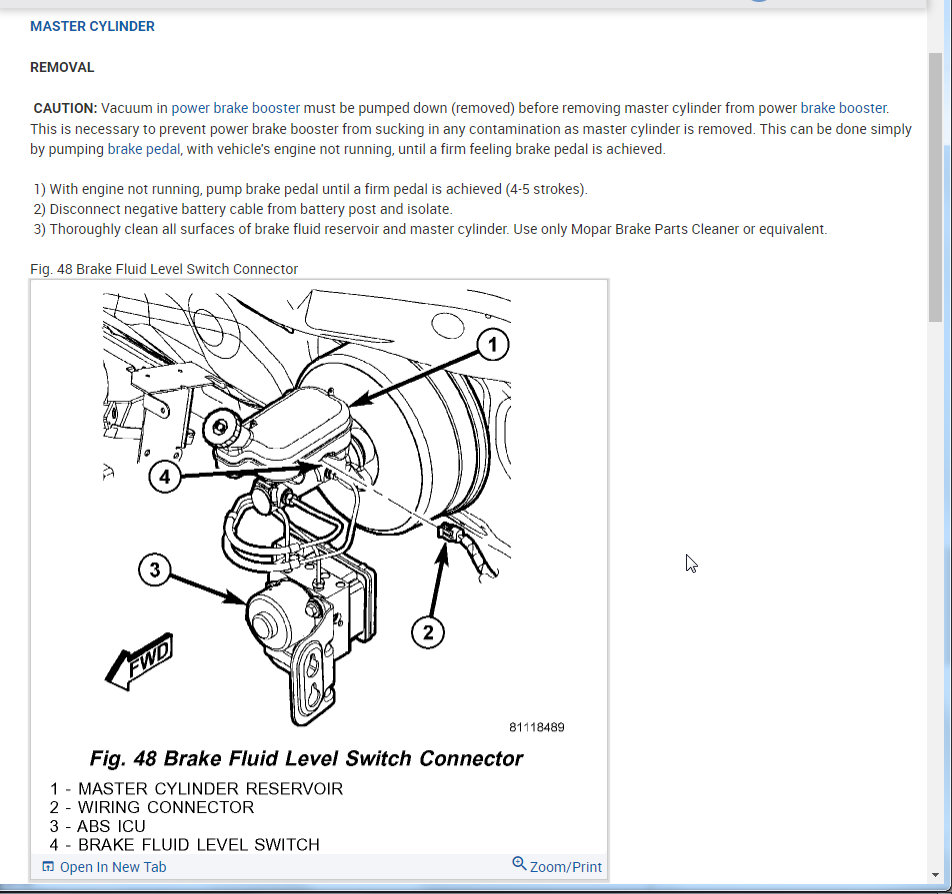

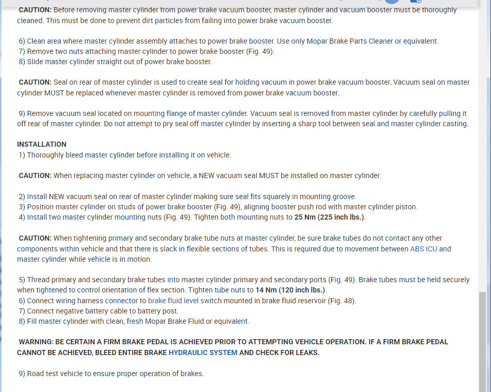

For starters here is a guide that will help with replacing it:
https://www.2carpros.com/articles/how-to-replace-a-brake-master-cylinder
Also, you are going to have to bleed the brakes so here is a guide that will help with this:
https://www.2carpros.com/articles/how-to-bleed-or-flush-a-car-brake-system
Below you will find the process from the manual. Please let us know if you have other questions. Thanks
