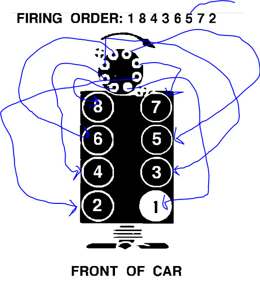

I need the diaphragm to where there spark plug wires go.

Hi, the firing order is 1 8 4 3 6 5 7 2. The distributor rotor rotates in a clockwise direction. If you look below, I attached a pic showing the setup.
I tried drawing lines for you to the correct cylinder, but I may have made it worse than it was. LOL
Take a look and let me know if this helps or if you have other questions.
See pic below.
