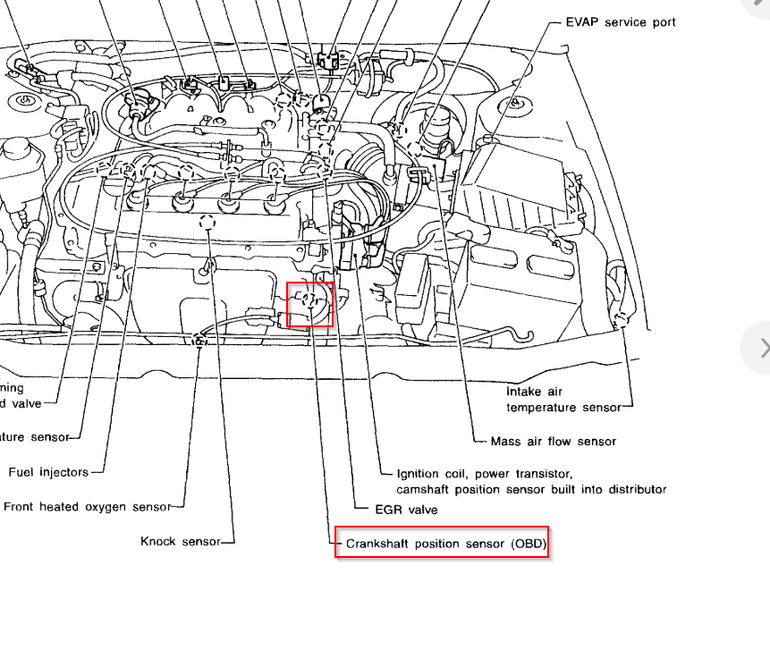

My car was engine was done overall and started but lost spark after being switched off. It does not want to start.

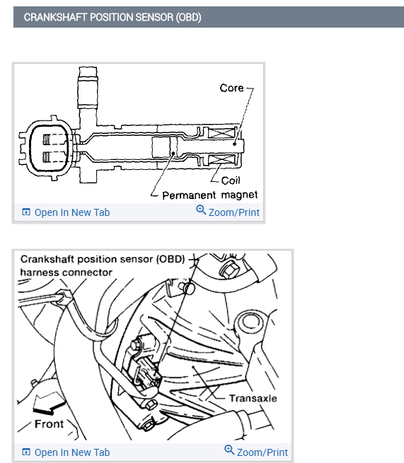

Yes it was engine rebuilt, mechanic started the car but suddenly when they have to test drive they car never started again and they say it does not have spark.
Saturday, November 23rd, 2019 AT 2:11 AM

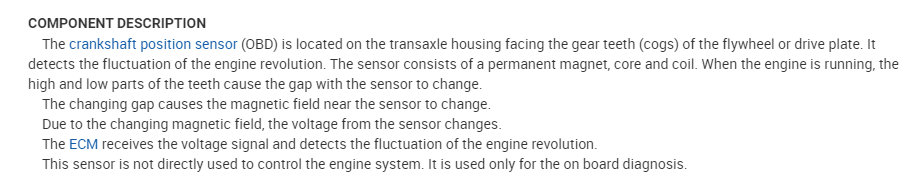

Okay. They need to start with checking the crank sensor. This is on the side of the engine and I am wondering if they damaged it or it just failed.
