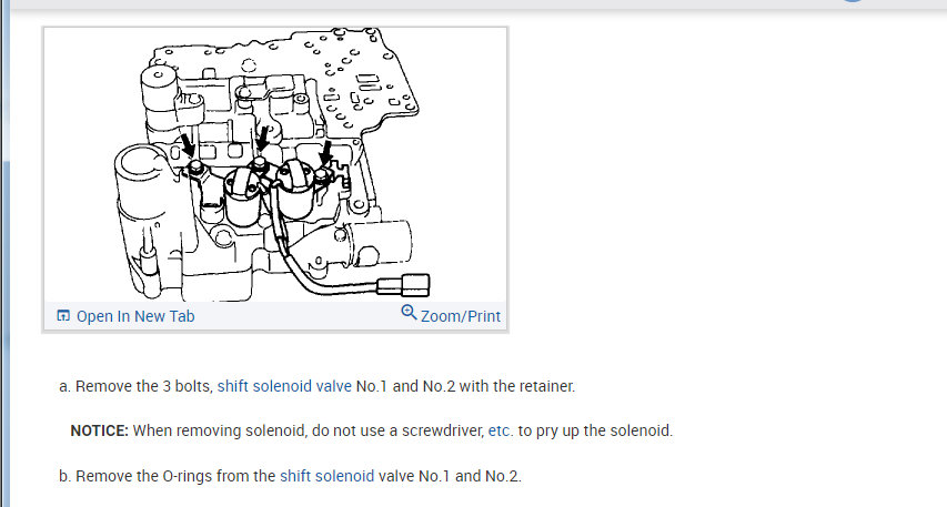

I have a code of p0758 the shift solenoid b is malfunction. Talked to a copy of shops I was given different answers. Not sure on the location and part. I just want to buy the right one.
Friday, March 5th, 2021 AT 12:26 PM
16 Replies

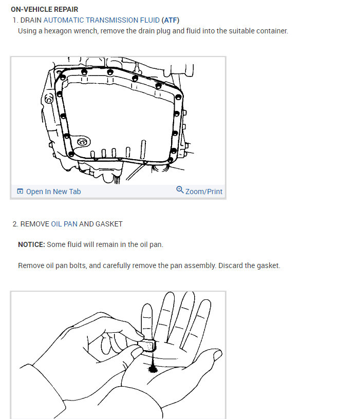

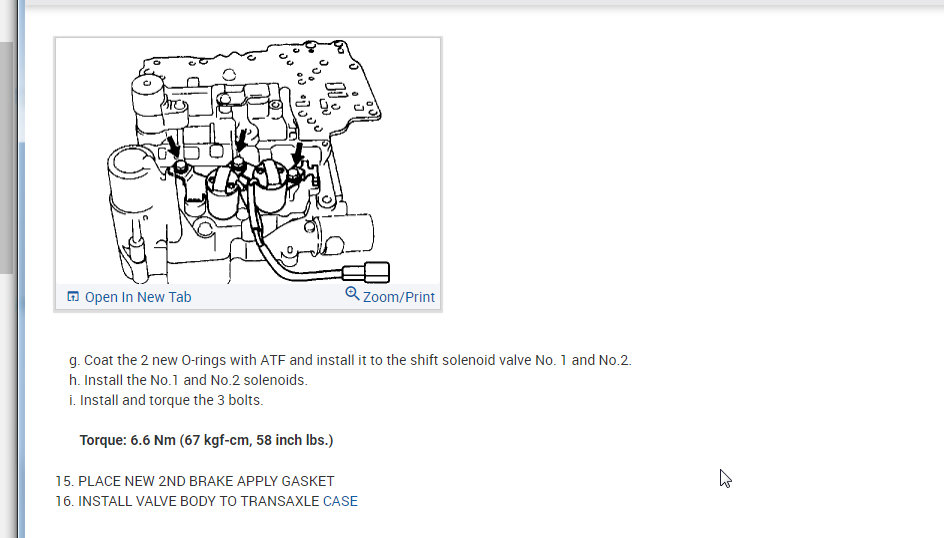

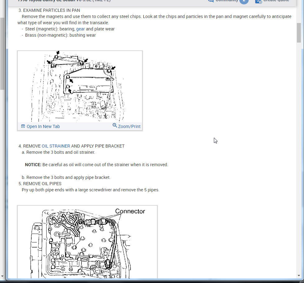

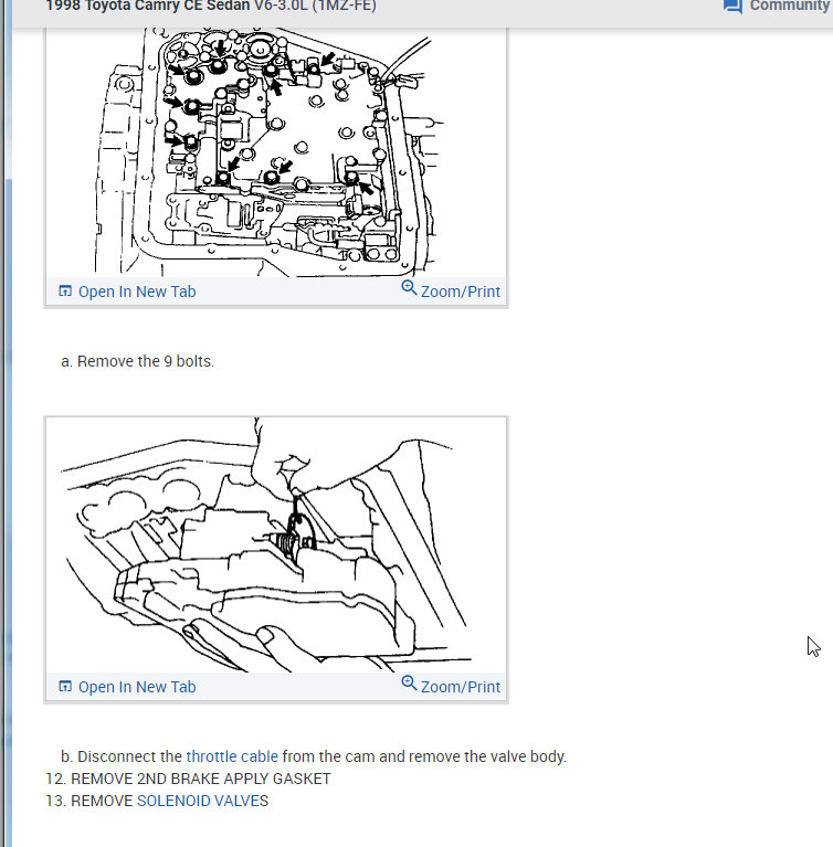

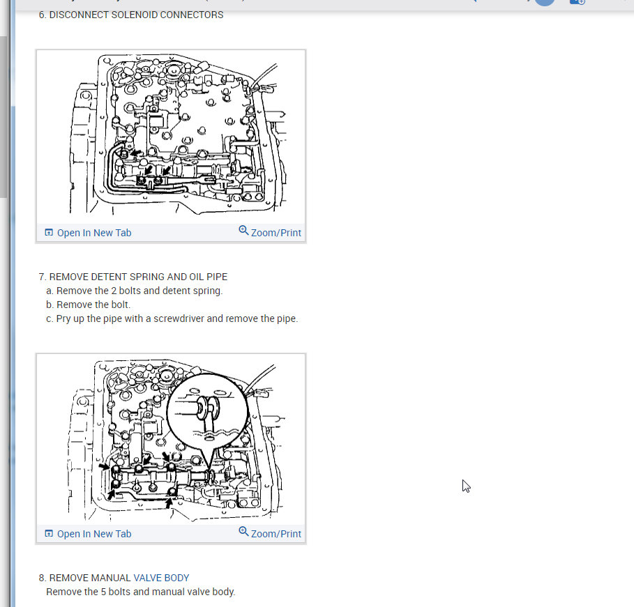

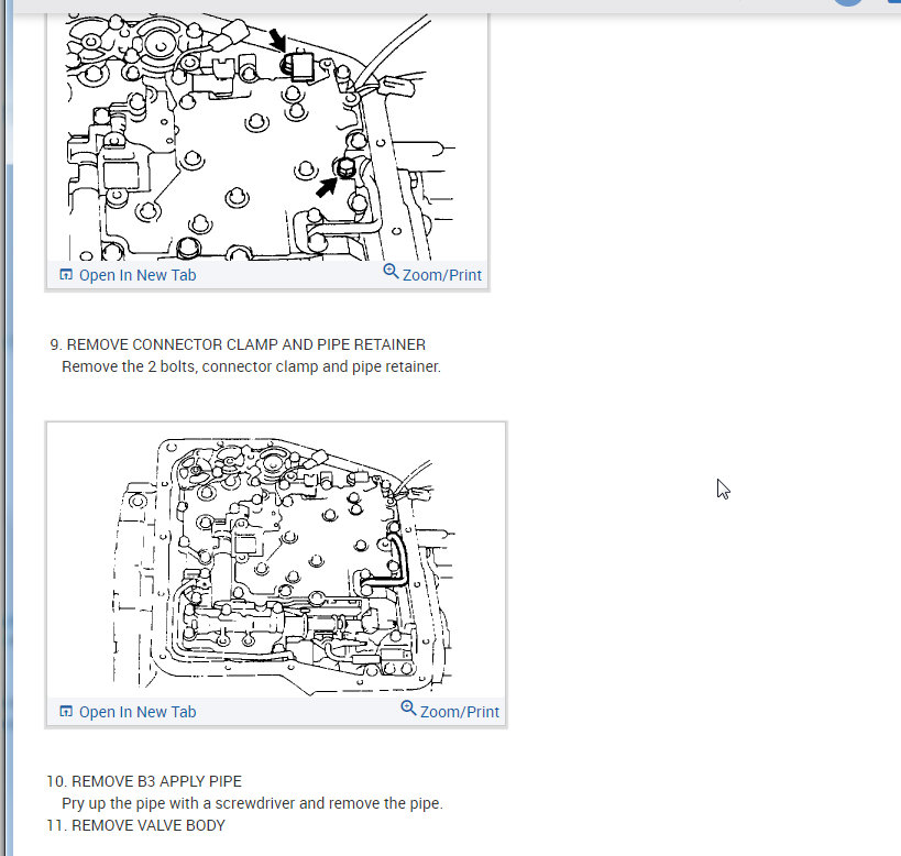

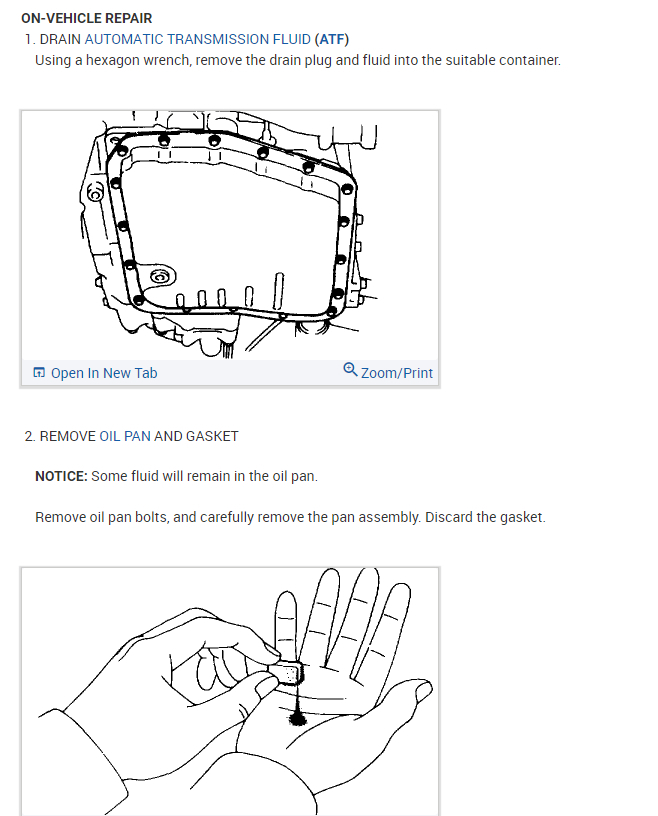

This could be a couple of things so we need to run through the testing that is attached below to find out for sure.
The shift solenoid is on the valve body in the transmission so if that is the issue then I attached the process to replace this as well.
However, this could also be a wiring issue or ECM so we need to run through the testing to find out for sure what the issue is.
Let's run through this material and let me know if you have questions. Thanks

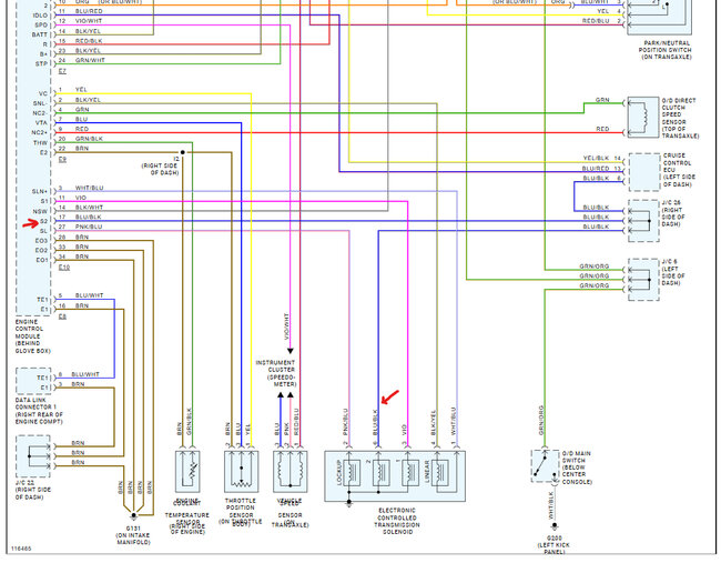

When you removed the solenoid did you test it with 12 volts and hear a click? Also, the solenoid "B" is the one that has the blu/blk wire going to it, can you confirm?
P0758 - Shift Solenoid B Electrical (Shift Solenoid 2)
Here is a guide to help check the wiring to the PCM.
Also, if you have a bidirectional scanner, you should be able to command the solenoid on and hear it click. Here are the wiring diagrams so you can check it out. Also, you might want to unplug the cruise control module as well in case it is blocking the signal. Check out the images (below). Please let us know what happens.

Ken, I greatly appreciate your help. When I removed the original solenoid, I tested it and it was perfectly fine (it clicked when 12 volts were applied and its resistance checked out according to my repair manual). I only swapped it out because I already had a new one and wanted to make absolutely sure that the solenoid wasn’t the culprit. I don’t remember if it was a blue and black wire going to the solenoid, but solenoid A and B have different brackets, so I know I ordered the right part and replaced the right solenoid.
I do not have a bidirectional scanner. Couldn’t I just apply 12v to the solenoid connector (only the B pin) outside the transmission and listen for a click? I don’t think the solenoid is the issue because sometimes my car shifts from 2-3 perfectly fine. It is very intermittent when it decides to slip down to 2nd or not go into 3rd gear at all. Usually only happens when accelerating.

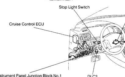

I did try unplugging the cruise control module yesterday since I saw that it was part of the wiring diagram and I cleared the CEL. It did not fix the issue unfortunately. The cruise control module is under the hood, correct? On the left side of the battery?
Monday, June 9th, 2025 AT 11:01 AM
KEN L
  • MASTER CERTIFIED MECHANIC
  • 55,244 POSTS
It says the cruise control module is on the left side of the dash. Check the image below.
