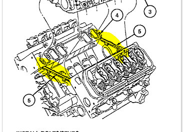

When you installed the lower intake, did you use a sealant on the end rails? Also, if you took anything off the manifold, such as the heater elbows, coolant temperature sensor, and so on, they should have been sealed with a sealant.
Take a look below. Did you use a sealant at the ends of the end seals?
See pic below. Also, with the hood open, let me know approximately where the smoke comes from.

Everything was sealed/reattached as per Ford repair manual specifications, including the sealant used on front and rear seals. The smoke has stopped since the 2nd startup since replacement. It might have been dirt/fluids burning off top of engine. It just started throwing the p304 code (cylinder #4 misfire)i double checked wires and replaced spark plugs and coil, which I think narrows it down pretty well to a vacuum leak for the RPM lag/rough idling problem. Thanks for the help/advice! I didn't want to take it all apart again without a second opinion.
