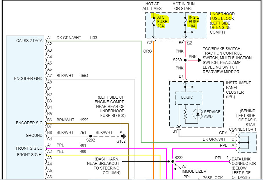

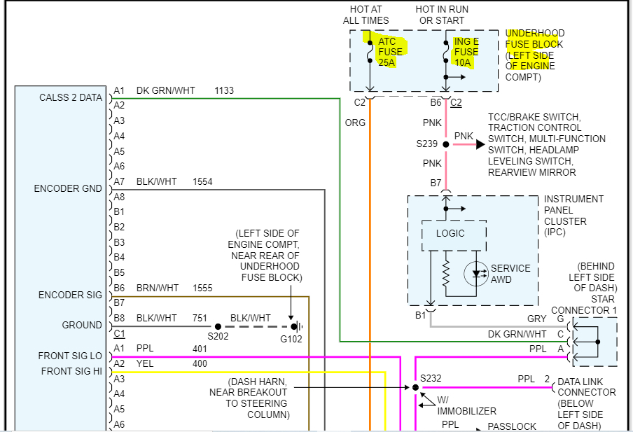

Does the scan tool power up and connect with the vehicle? Also, I attached the wiring schematic below. Are these the fuses you checked?
Bravada's "Smart Trak" system has a computer-controlled NP-136 transfer case. It runs in RWD under normal operations, and only when wheel slip is detected does the "SmartTrak" kick into AWD.
With that in mind, is the ABS light on as well? We could simply have a wheel speed sensor which is an issue.

I haven't checked these fuses yet. If I'm reading this correctly, these fuses are inside the vehicle, underneath the dashboard on the driver's side? Or is this cluster of fuses on the side of the dashboard inside the vehicle on the driver's side?

Update: Both fuses, ATC (25A) and the ING E (10A) are intact.
Thursday, October 19th, 2023 AT 5:36 AM
  • 110,194 POSTS

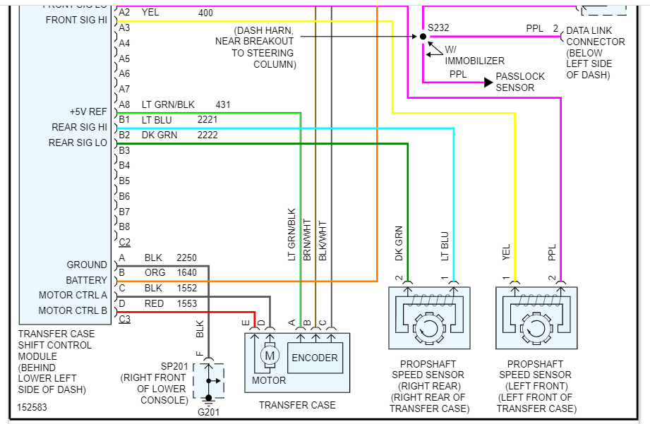

If there is power to and from them, then we need to check if the transfer case shift control module has power at the orange wire from the fuses.
The transfer case module is in the vehicle under the left side of the dash. Is this something you are comfortable performing?
As far as the IGN E fuse, if there are no ABS indicators, the sensors and fuse are good.

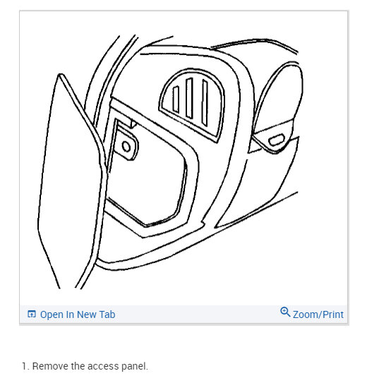

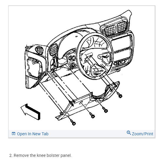

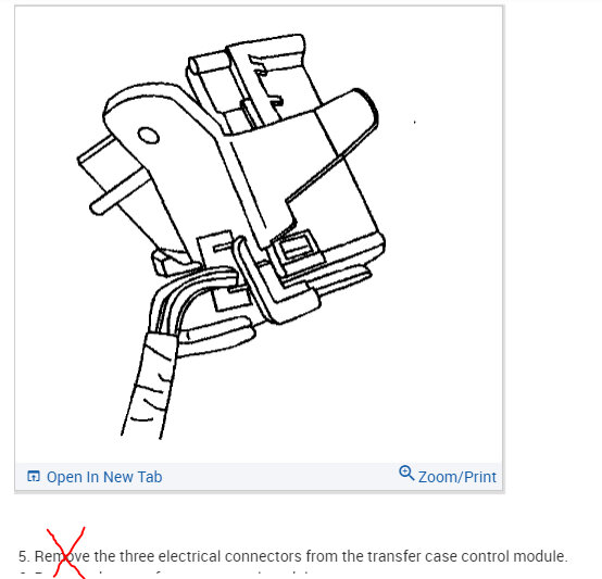

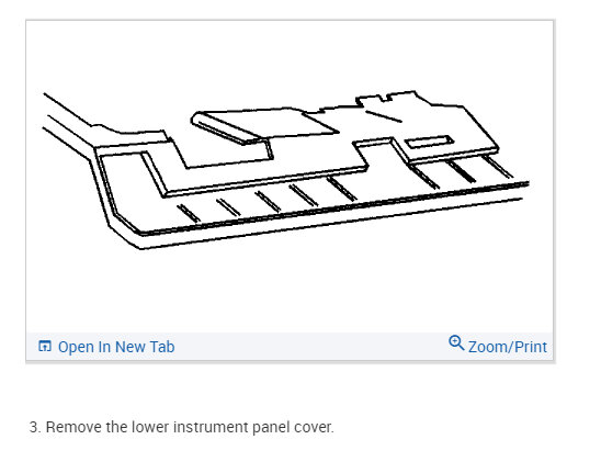

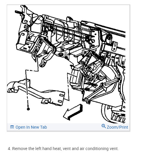

No problem. We need to first access the module which is under the dash on the driver's side of the vehicle.
I attached directions to access (or remove) the module. All we need to do is access it.

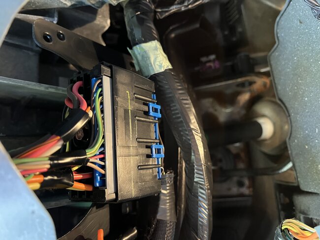

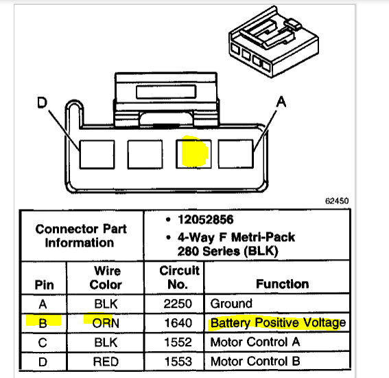

At the module, there will be three electrical connectors. Two will have several wires and one of them will only have four wires. One of them is the orange wire. See the last pic below.
If you can, back probe the orange wire to check for power. If you are unable to back probe it, remove only that connector and check the pin for the orange wire for power. You can use a voltmeter, multimeter, or test light for this test. Whichever you have will work.
Let me know what you find.
See pics below. Note: The directions indicate removing the vent tube (pic 4). I can't remember if that is necessary, so double-check before you give yourself more work. LOL

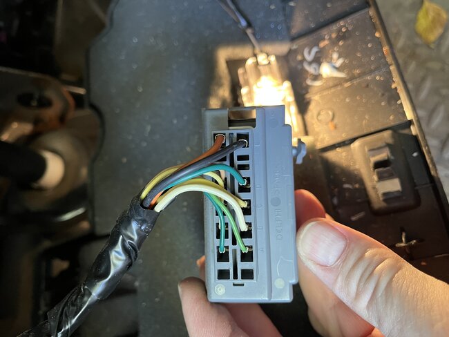

Okay, I got some things removed. I see 2 plugs that are roughly 3” long. (See pics).
Do I want to probe the orange wire from the grey plug?

Here are the pics.
Friday, October 20th, 2023 AT 9:57 AM
JIMMYPAGE
  • 42 POSTS
Update: probing the orange wire from the grey plug, my test light turns on.
Friday, October 20th, 2023 AT 10:01 AM
  • 110,194 POSTS
Thanks for the update. If you have power present, there is a chance the module itself has failed. Is your scan tool bi-directional? We need to see if the module can be actuated manually via a scan tool.
However, check to make sure the black wire has continuity to ground. It could be a ground issue as well.
