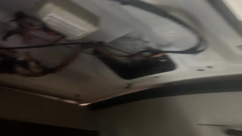

I am sure you have seen this before, can you tell me what can cause it? Both doors open from buttons on head panel or from buttons on side but not when i lift the handles both while closed or open, don't they open like odysseys? Passenger side works but i have to lift it to move or it just keeps making this noise. I'll send video.

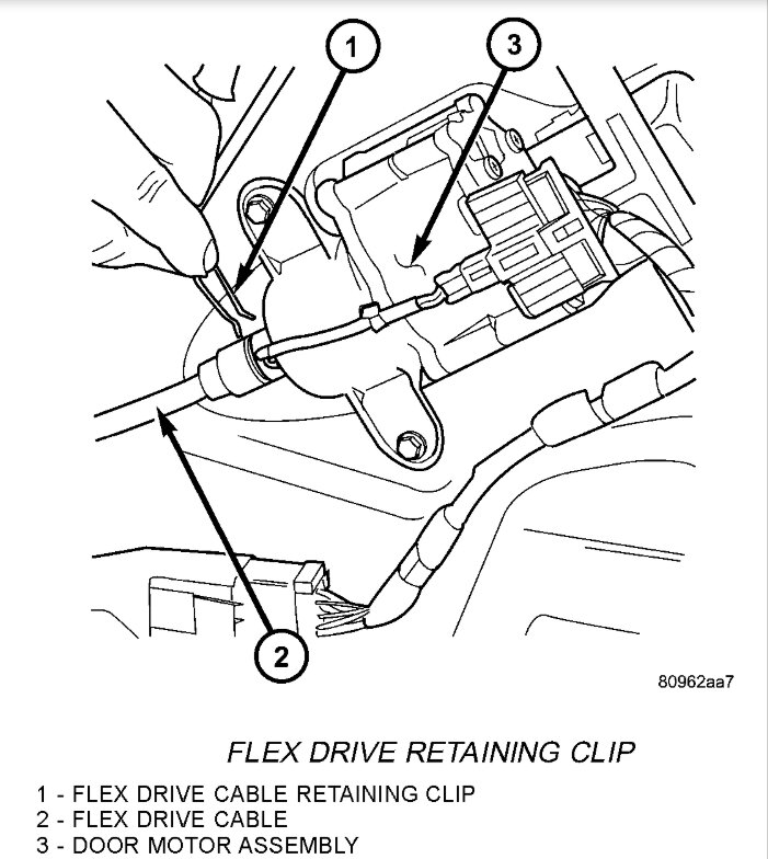

Yep, the is a stripped drive gear on the cable control system, you will need to remove the drive motor for inspection/replacement. Make sure the drive is not stripped. Check out the images (below). Please upload pictures or videos in your response.

Remove the door panel on the sliding door. The drive motor should be there.

And this ring is inside the motor? Or just get a motor assembly if its stripped i guess.
Sep 18, 2025 at 4:32 PM
  • 54,494 POSTS
You can open up the motor to help confirm the issue.

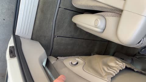

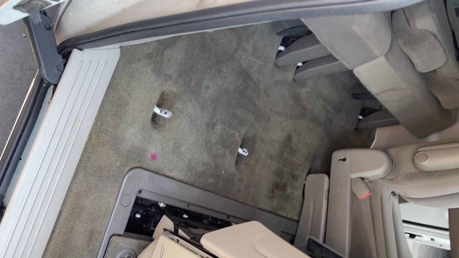

the sliding door makes. noise when I want to close the door but it won't move and just makes that noise until I help it by pulling on the handle that is on the outside for it to move and close

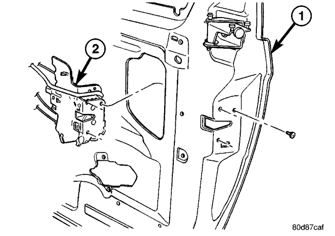

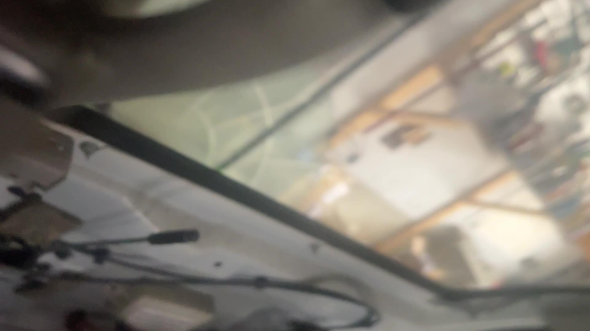

I removed the door cover, it turned out it was actually the lock door actuator making the noise not the slide door motor, I was mistaken. How hard are they to replace
Sep 20, 2025 at 2:55 PM
  • 54,494 POSTS
It is not to difficult to do, here is a diagram to help.
Sep 21, 2025 at 8:34 AM
BHAMDOC1973
  • 2,007 POSTS
Ugh, replaced it and same thing, its coming from the assembly it attaches to i guess. What is it called?
Sep 22, 2025 at 3:09 PM
  • 54,494 POSTS
Yep, that is the drive motor, it is bad. Thanks for the video it helps.

I replaced the latch assembly with the motor and the noise went away but now am dealing with the issue of closure which I asked a new question about
