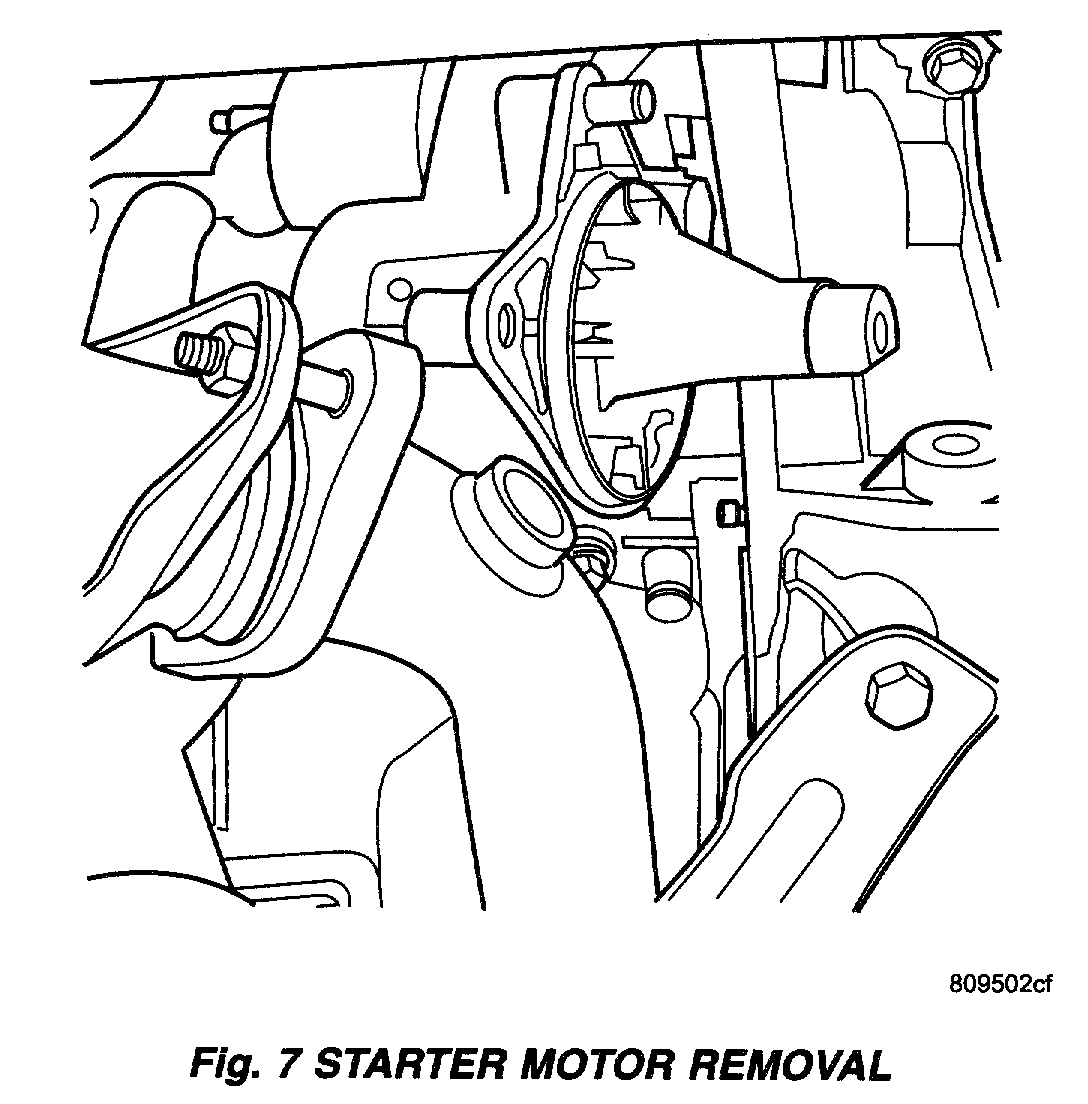

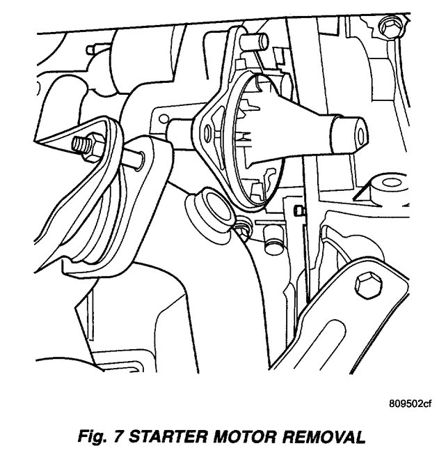

If you determine that the starter is bad, here are the directions for replacing it. The attached pictures correlate with these directions,.

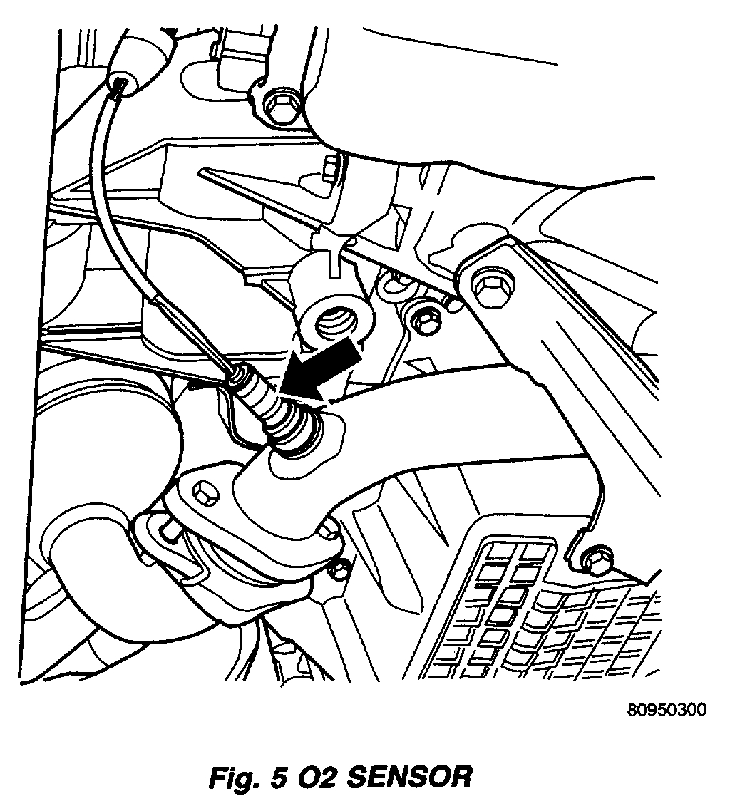

Fig.5 O(2) Sensor
5. Remove the O(2) sensor from the exhaust manifold (Fig. 5).

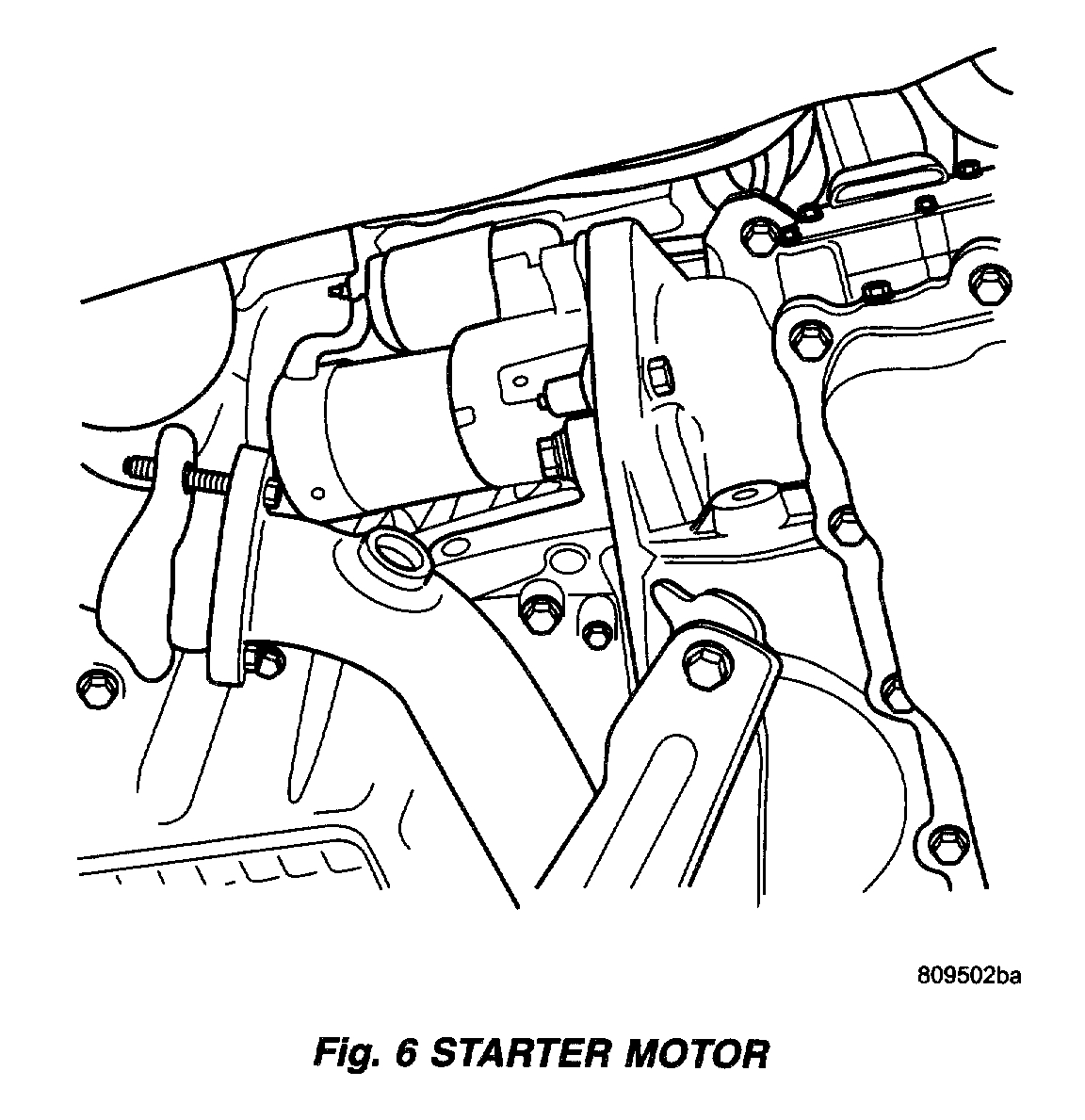

Fig.6 Starter Motor
8. Remove the battery cable from starter (Fig. 6).

9. Remove the lower starter bolt and remove starter (Fig. 7).

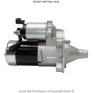

As far as replacement, the solenoid can be replaced, but honestly, no one does it anymore. The entire starter is replaced which includes the solenoid. I attached a picture of a starter for you to see. The larger portion is the starter motor. The smaller cylindrical component attached to the top of the motor is the solenoid.
I recommend just replacing the entire component.
