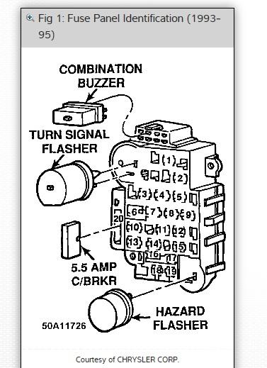

Fuse panel location picture of the flasher relay

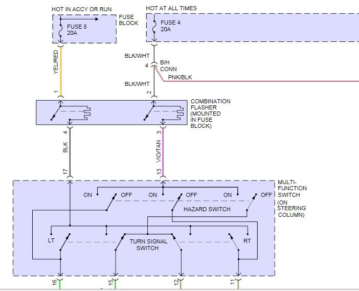

Did you check the fuses? Did you check voltage at fuse circuits. Usually the turn fuse circuit goes hot with the key on. The flasher fuse circuit should be hot all the time.
It's possible you will have to check the multifunction switch? If so, make sure you disarm the air bag before working on steering column.

Going by your drawing, there is NO fuse in number 8 slot. Never been one as there is only 1 contact in the slot. Hazards work, tried a new relay didn't help. Have power in one slot where relay goes nothing in others when turn signal is in left/right position. Everything points to multifunction switch. Just don't understand why it happened all of a sudden.

I know now that the Sport wiring diagram is different than a regular Jeep. The hazards work, the flash to pass works and the wipers work. I tried a new flasher (hazards/signals) and still didn't work. I have tested and removed for inspection all of the fuses. The horn, turn signals and rear window heater relays are on a block under the drivers knees right of the steering wheel column. Any idea?

Our database says fuse block under left side of dash. If our database is wrong about fuse block location and the wiring diagrams are wrong, I'm not sure how to help?
It does show relay block to the right of steering column. I'm not giving up yet.

Fuse block is in the normal spot, above left foot of driver.I wonder if there's any difference if the Jeep was made in Canada.(Just wondering).

In the fuse block to the left, is there a fuse 8--20 amp?

Nothing is slot 8. Never had one.

Our database shows a fuse 8 in left fuse box. Either our database is wrong or I'm looking in the wrong place? I've looked at other databases, same fuse 8--20amp.
All I can do is hope the wiring colors are correct from flasher to multifunction switch for turn signals. Then look under the dash for proper wire color going into steering column. Should be multiwire electrical connector where wires go into steering column, check voltage on that wire, key on, turn switch on. If no voltage backtrack the wire.

Just to add, this diagram says it is for 95 jeep Cherokee sport 4.0L.

I agre. Everything I've seen says that's the fuse block, but not the one I have. I can send you a photo if I can have your email address, or if you're on Facebook. Thanks for your help.

Besides. Stop and think about it, if the flasher relay is under the dash next to the steering column, WHY would there be another flasher in the fuse block.I see that I can add an image.I'll send a photo of the fuse block tomorrow..

In one of your posts, didn't you say only one hot terminal at flasher? My thinking is, should be two hot terminals with key on, one hot terminal with key off.
How many pins on flasher? Are there pin numbers? Even with one hot pin, using a jumper, you should be able to check hazard and turn, they just won't flash, should lite-up.
If turn signals will lite, one side then the other, then I think problem is before the flasher. If they won't lite up, then I think the problem is in the steering column, wiring or multifunction switch.

I've attached a photo of the fuse block.. As you can see there is no fuse in #8.
