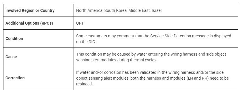

My display is showing ‘service side detection system’. Will this cause my car to fail inspection? (NY)

Good morning,
Is the check engine light on? If it is, then yes, it is a failure. If it is not then no, it will not affect your inspection.
The requirements are no check engine light and all monitors set.

No engine light just the side detection check. Thanks for the reply.
