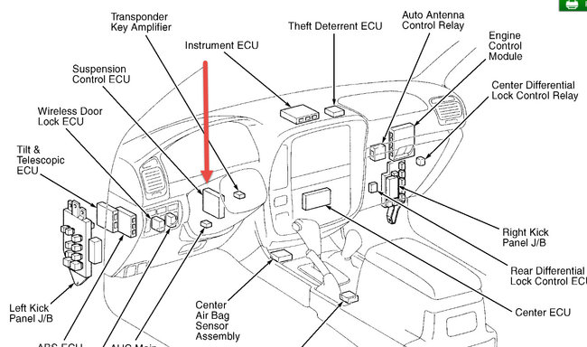

Please can I get a picture of height control module?
Oct 11, 2016 at 1:41 PM
HMAC300
  • CAR REPAIR CONTRIBUTOR
  • 48,601 POSTS
see picture it is under the dash driver's side.
Oct 11, 2016 at 3:05 PM
HENRY DANIEL
  • 6 POSTS
Thank you so much, the information has been very helpful. The man handling my car seems not to be very experienced. Please do you need to loosen down the dash board before you can have access to the height control module?
Oct 11, 2016 at 6:53 PM
HENRY DANIEL
  • 6 POSTS
I really appreciate your assistance so far. Kindly show in steps how to get to the height control module. To avoid tampering with other gadgets.
Oct 12, 2016 at 1:41 AM
HMAC300
  • 48,601 POSTS
Sorry, we do not have instructions for that. it is more of start removing panels on bottom of dash and get it out on your own.
