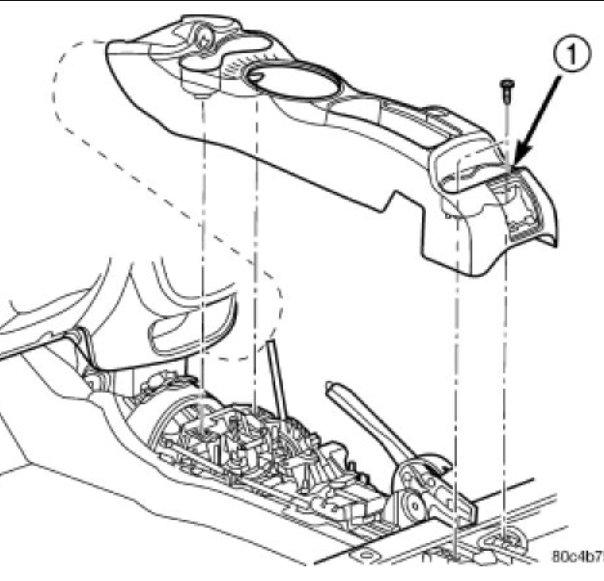

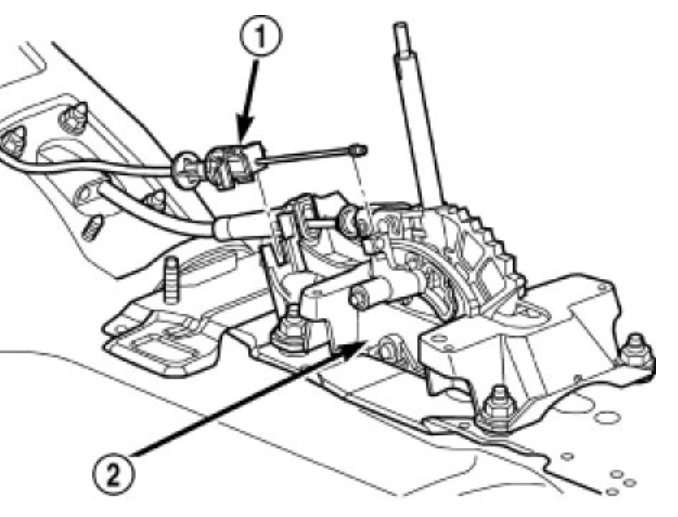

Once in neutral it will go into drive easily and first and third gear easily. Once you attempt to shift to reverse it becomes very difficult but refuses to shift into park. What could resolve this issue?
May 9, 2020 at 7:44 PM
DANNY L
  • CAR REPAIR CONTRIBUTOR
  • 5,648 POSTS
Hello, I'm Danny.

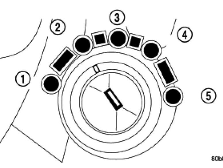

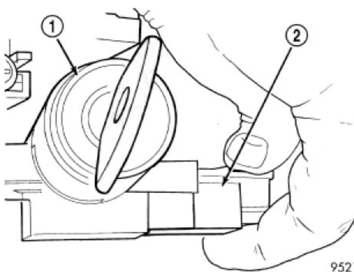

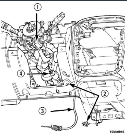

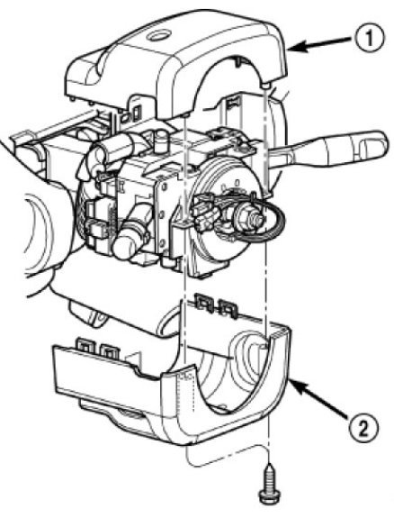

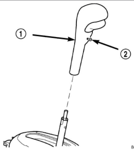

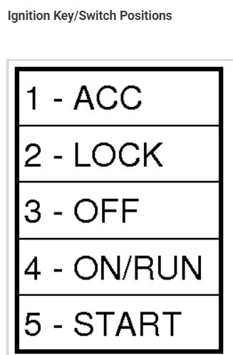

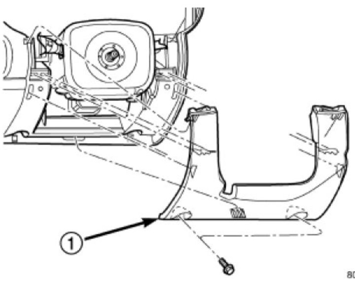

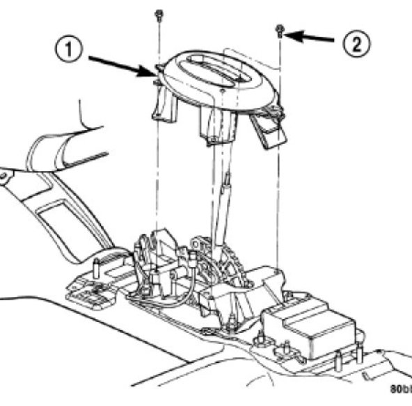

It sounds like you might be having an issue with the shift interlock cable.
I've attached picture steps below showing how to replace for your car below.Hope this helps and thanks for using 2CarPros.
