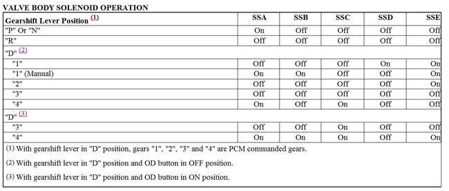

Chart shows the solenoid operations in the various modes. Did you test if there is any difference when OD button is turned on or off?
For testings of solenoid operations, a scan tool would be the easiest way to go about. It can read the various circuits and allows you to test the solenoids.

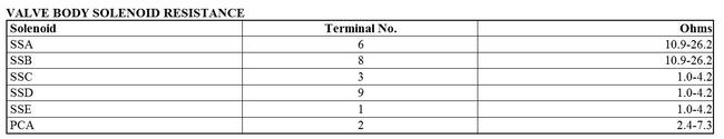

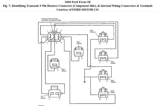

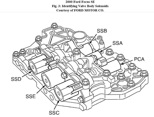

VALVE BODY SOLENOIDS
Raise and support vehicle. Remove transaxle oil pan to access valve body solenoid assembly. Disconnect solenoid wire connector(s). See Fig. 3 . Using an ohmmeter, measure resistance between specified terminal(s) and solenoid body. See VALVE BODY SOLENOID RESISTANCE table. See Fig. 7 . If resistance(s) is within specification, solenoid is okay at this time. If resistance(s) is not within specification, replace faulty solenoid(s) and retest system operation.
