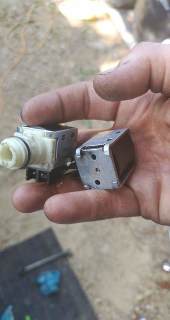

What are the steps to replace the shift solenoid A 1-2 and 2-3? What parts do you have to remove to get to the shift solenoids?

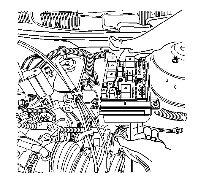

1. Remove the air cleaner housing assembly. Refer to Air Cleaner Assembly Replacement (See: Air Cleaner Housing > Removal and Replacement > Air Cleaner Assembly Replacement).
pic 1
2. Remove the underhood electrical center from the bracket.
3. Remove the underhood electrical center bracket.

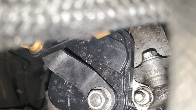

4. Disconnect the shift cable from the PNP switch.
5. Remove the shift cable bracket.
pic 3

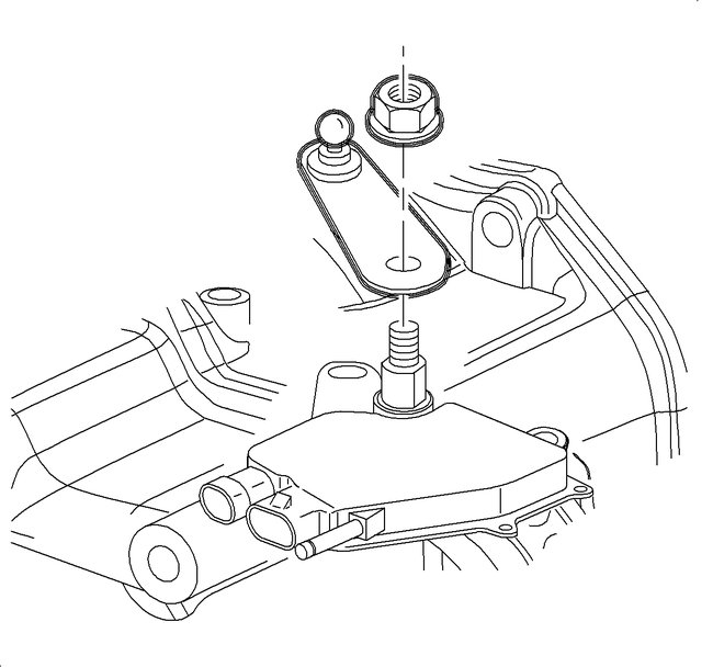

6. Remove the PNP switch lever nut and lever.
pic 4
7. Remove the PNP switch. Refer to Park/Neutral Position Switch Replacement (See: Transmission Position Sensor/Switch, A/T > Removal and Replacement > Park/Neutral Position Switch Replacement).

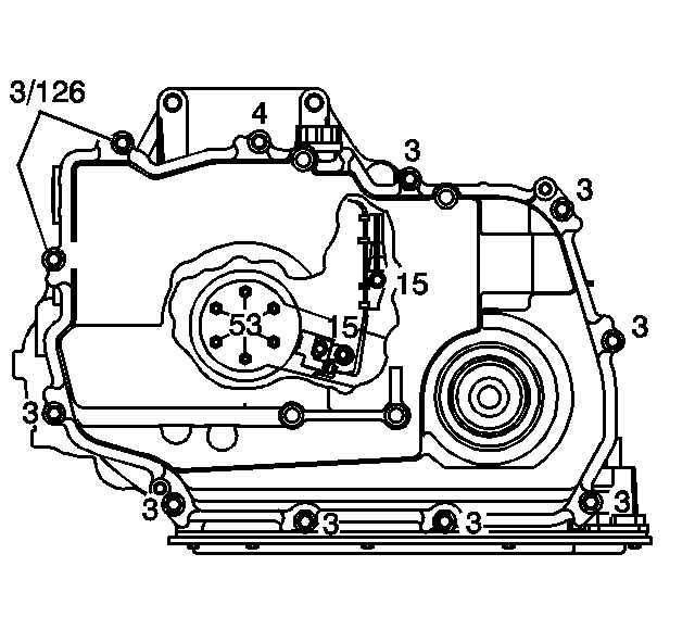

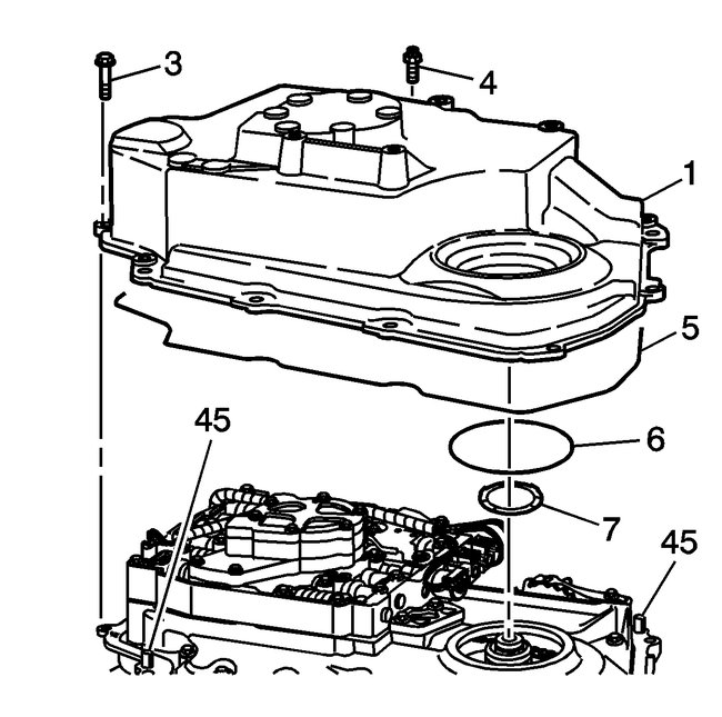

pic 5

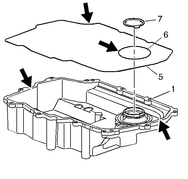

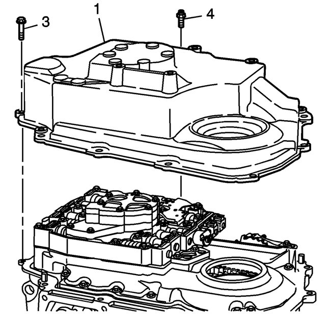

20. Remove the 11 transmission side cover bolts (3) or Studs (4) (model dependant).
Caution: Pry on the corner of the case side cover near the locating dowel pins (45), to prevent damage to the sealing surfaces.
21. Remove the transmission side cover (1).
22. Remove the two side cover gaskets (5 and 6) and the side cover to driven support thrust washer (7). They may remain with the side cover. Only replace if necessary.

pic 6
1. If the seals were removed, thoroughly clean and dry the side cover seal grooves and the side cover seals.
2. Install the side cover gaskets (5 and 6) into the grooves on the side cover (1).
3. Retain the seals with J 36850 or equivalent.
4. Install the side cover to drive sprocket thrust washer (7) onto the side cover.
5. Retain the thrust washer with J 36850 or equivalent.
pic 7
6. Install the side cover assembly onto the transmission case.
7. Install the 11 side cover bolts (3) or studs (4) (model dependent).

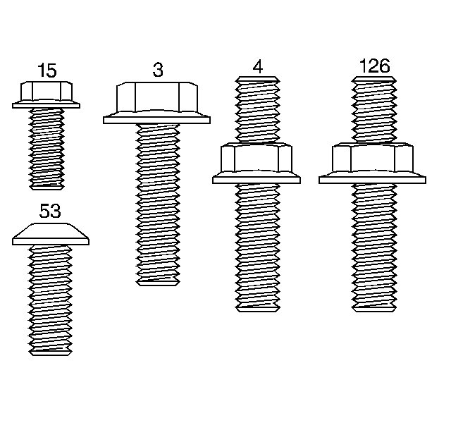

pic 8
8. Refer to the graphic in order to find the correct installation points of the bolts and the stud.
pic 9
Caution: Refer to Fastener Caution (See: Vehicle > Vehicle Damage Warnings > Fastener Caution).
9. Hand start the bolts (3) and tighten the side cover bolts and stud to 28 Nm (22 lb ft).

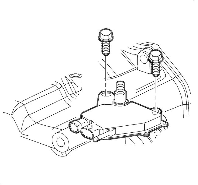

pic 10
22. Install the PNP switch. Refer to Park/Neutral Position Switch Replacement (See: Transmission Position Sensor/Switch, A/T > Removal and Replacement > Park/Neutral Position Switch Replacement).
pic 11
23. Install the PNP switch lever and nut and tighten to 35 Nm (26 lb ft).
pic 12
24. Install the shift cable bracket.
25. Connect the shift cable from the PNP switch.
pic 13

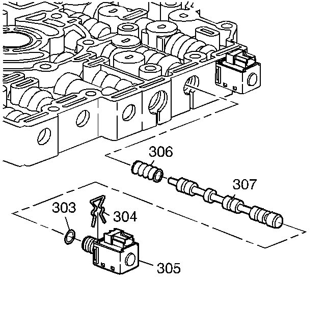

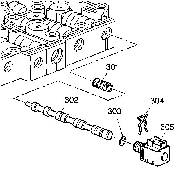

1-2 SHIFT SOLENOID VALVE REPLACEMENT
1-2 Shift Solenoid Valve Replacement
Removal Procedure
Important: Retainer clips hold in each of the valve line-ups. Use a small screwdriver in order to remove the retainer clips. Be careful not to score the valve body when removing the retainer clips and valves. Before removing the valve line-ups, inspect each valve line-up for freedom of movement.
See pic 14
1. Remove the transmission side cover. Refer to Control Valve Body Cover Replacement (See: Valve Body, A/T > Removal and Replacement > Control Valve Body Cover Replacement).
2. Remove the 1-2 shift solenoid retainer clip (304), the 1-2 shift solenoid (305) with O-ring (303), the 1-2 shift valve (302), and the 1-2 shift valve spring (301).
Installation Procedure
See Pic 15
1. Install the 1-2 shift valve spring (301), the 1-2 shift valve (302), the 1-2 shift solenoid (305) with O-ring (303) and the 1-2 shift solenoid retainer clip (304).
2. Install the transmission side cover. Refer to Control Valve Body Cover Replacement (See: Valve Body, A/T > Removal and Replacement > Control Valve Body Cover Replacement).
Important: It is recommended that transmission adaptive pressure (TAP) information be reset.
Resetting the TAP values using a scan tool will erase all learned values in all cells. As a result, The ECM, PCM or TCM will need to relearn TAP values. Transmission performance may be affected as new TAP values are learned.
3. Reset the TAP values. Refer to Transmission Adaptive Functions (See: Automatic Transmission/Transaxle > Components > Transmission Adaptive Functions).

2-3 SHIFT SOLENOID VALVE REPLACEMENT
2-3 Shift Solenoid Valve Replacement
Removal Procedure
pic 16
2. Remove the 2-3 shift solenoid retainer clip (304), the 2-3 shift solenoid (305) with O-ring (303), the 2-3 shift valve (307), and the 2-3 shift valve spring (306).
pic 17
1. Install the 2-3 shift valve spring (306), the 2-3 shift valve (307), the 2-3 shift solenoid (305) with O-ring (303) and the 2-3 shift solenoid retainer clip (304).

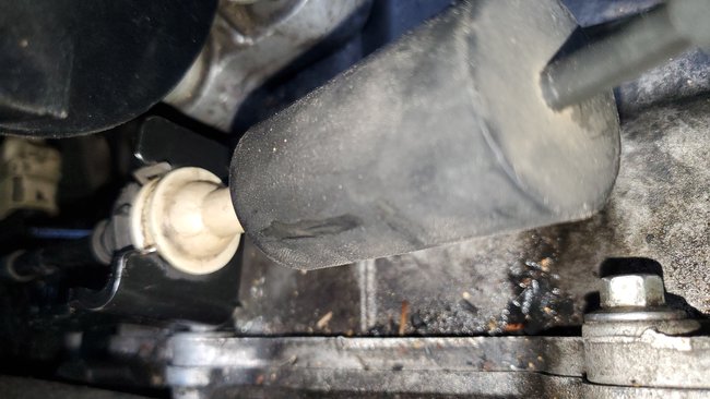

DUWHOP31
  • 151 POSTS

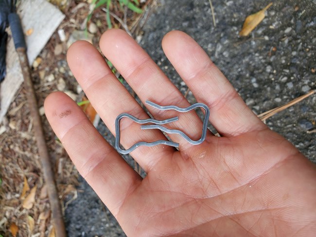

Real quick. when I put the new solenoids in which way does the clip go? From the bottom pushed to the top, from the top pushed to bottom or from the sides?
Jul 11, 2019 at 7:26 AM
DUWHOP31
  • 151 POSTS
These clips.
Jul 11, 2019 at 7:27 AM
DUWHOP31
  • 151 POSTS
My bad these clips:
Jul 11, 2019 at 7:34 AM
  • 110,193 POSTS
Welcome back:
LOL they go from the top down. A very easy thing to miss. Take a look at the last picture I posted above.
Let me know if you have other questions and if this takes care of the problem.

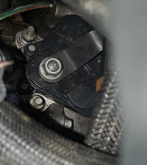

Do you know where the shift linkage and bracket go back on to?
Jul 13, 2019 at 9:05 AM
  • 110,193 POSTS
Welcome back:
I believe that is near the heat shield on the exhaust. See if the attached picture helps.
Jul 13, 2019 at 7:29 PM

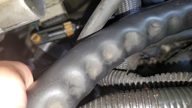

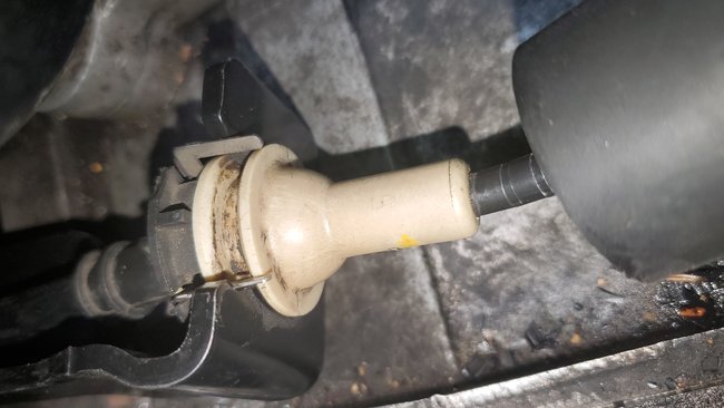

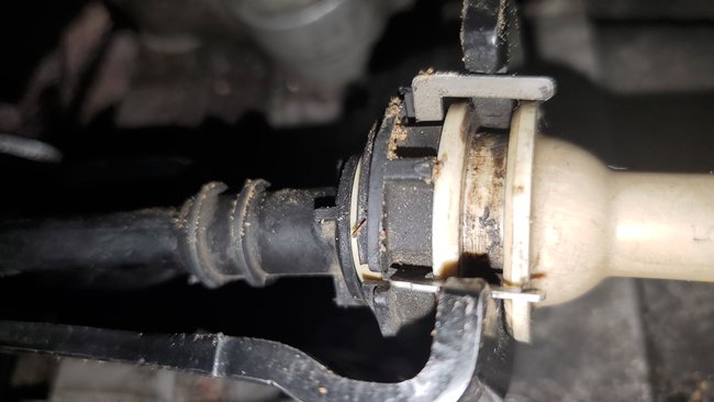

When I put my car in reverse and neutral and press the gas it goes forward.
Jul 16, 2019 at 9:35 AM
  • 110,193 POSTS
Welcome back:
Interesting. Are you able to get reverse at all? Let me know. Also, I noted that you attached pics of the shift cable. Here are the directions for adjustment. The attached picture correlates with the directions.

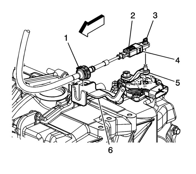

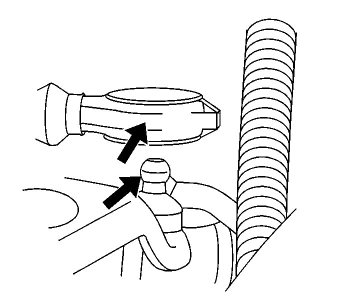

4T45-E - AUTOMATIC TRANSMISSION
Shift Control Cable Adjustment
1. Place the shift control lever in the PARK position.
see pic 1
2. Carefully remove the shift cable end (3) from the transmission range select lever (5).
3. Release the shift cable retainer (3) from the shift cable bracket (6).
4. On the underside of the cable adjustment lock protective sleeve (4), release the retaining tab using a flat bladed tool.
5. Slide the cable adjustment lock protective sleeve (4) toward the end of the cable (3) to expose the cable adjustment lock (2).
6. Release the cable adjustment lock (2) to allow freedom of movement of the cable end (3).
7. Secure the shift cable retainer (3) to the shift cable bracket (6).
8. Secure the shift cable end (3) to the transmission range select lever (5).
9. Insure both the shift control lever and the transmission range select lever (5) are in the park position.
10. Depress the cable adjustment lock (2) to secure the adjustment of the shift cable end (3).
11. Slide the cable adjustment lock protective sleeve (4) over the cable adjustment lock (2).
12. Test the shift control lever in all positions for proper gear range selection.
_____________________
Let me know if that is what was needed or what exactly is happening as far as can you get reverse, park, and neutral in different shift positions.
Jul 16, 2019 at 8:17 PM
DUWHOP31
  • 151 POSTS

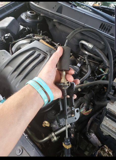

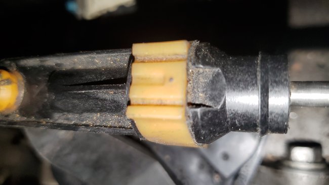

So today I messed around with the shift linkage then started the car and it went in reverse and felt like it was going to go in reverse so I got out the car and shut the hood and went to put it in reverse again and it didn't go anywhere.. does it matter if the bracket in the first picture isn't bolted on or does it have to be. When I have it in park does the neutral safety switch have to be all the way to the left like the second turpitude? Do I need to do anything with the adjuster or whatever it's called in the first picture I just uploaded?
Jul 16, 2019 at 9:15 PM
DUWHOP31
  • 151 POSTS
So I don't need to mess with label (1) at all? And label (2) (3) and (4) are all together already.. I loosened the bolt and moved the Transmission range sensor all the way to my left. Is that right? Do the 2 bolts that hold the transmission range sensor on the transmission have to be all the way tightened? like if the back 1 isn't all the way tight would that make it not go in reverse?
Jul 16, 2019 at 9:24 PM
  • 110,193 POSTS
Welcome back:
The bracket is what enables the cable to move the shift lever. If that isn't bolted on, the transmission will not shift or at least not shift properly. Bolt that on and let me know what happens.
Jul 16, 2019 at 9:57 PM

Is this not how it goes?
Jul 17, 2019 at 11:52 AM
  • 110,193 POSTS
Welcome back:
That looks correct. Is the bracket that holds the shift cable mounted?
Jul 17, 2019 at 6:00 PM
DUWHOP31
  • 151 POSTS
No sir. okay, so mostly all of the transmission side cover bolts were 10mm but maybe 2 or 3 were 13mm so i need to know if the bracket goes on top of the transmission where the 1st 13mm bolt is on top closet to you if you were looking up under the hood (front of the car) and what else could I be doing wrong? Or not getting right? 1 more question so when I did take the side cover off a lot of transmission fluid leaked out. I do not know if all of it did or not so I only put a total of 5 quarts back in (my car manual says 7 qts) could the fluid be too low ?
