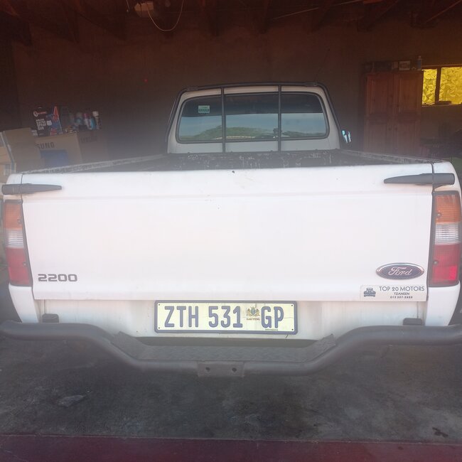

There is no 2.2-liter engine for this truck, does it have a different engine? Can you please upload an image of the engine so I can confirm? There is a 2.3-liter engine, but it does not have an ignition distributor.
Jan 15, 2025 at 6:43 PM
SAMUEL BUTIKI KULA

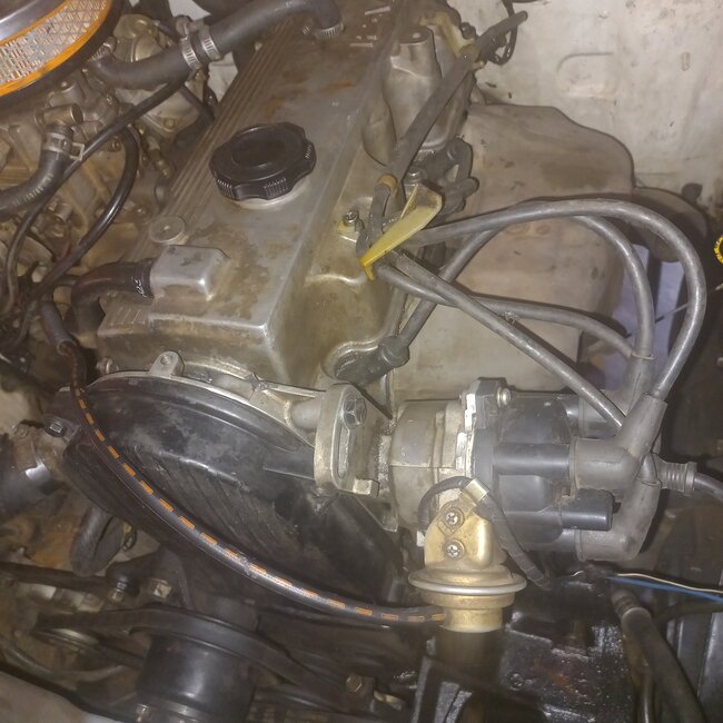

Yes there is, it is 2200 (2.2) see attached photos.
Jan 15, 2025 at 11:53 PM
  • 54,503 POSTS
Yep, that is not a Ford engine, it looks like a Mazda. The timing can be correct even though the timing adjustment is not in the center, is this the only problem you are having?

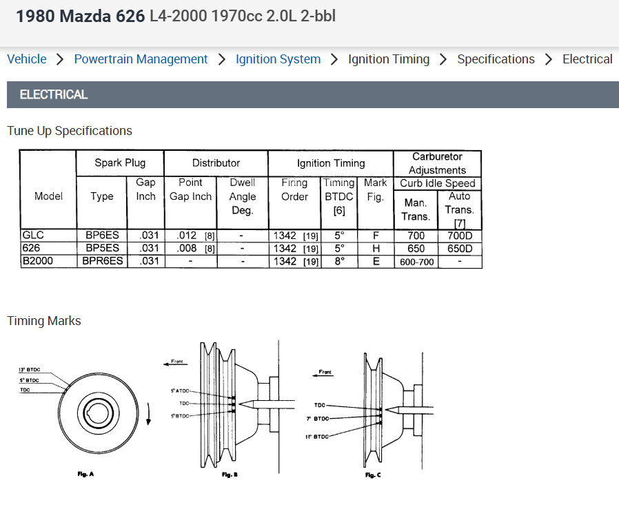

Yes, this might be. You will need a timing light to set the timing at 8 degrees TDC. Please go over this guide as well:
Check out the images (below). Let us know what you find.
