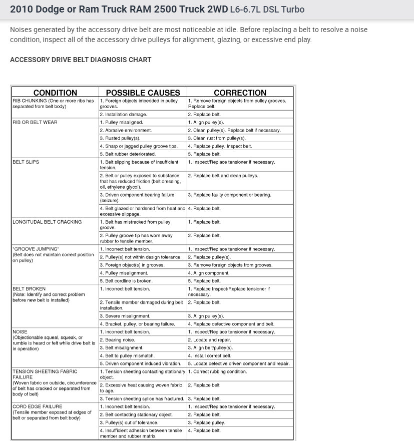

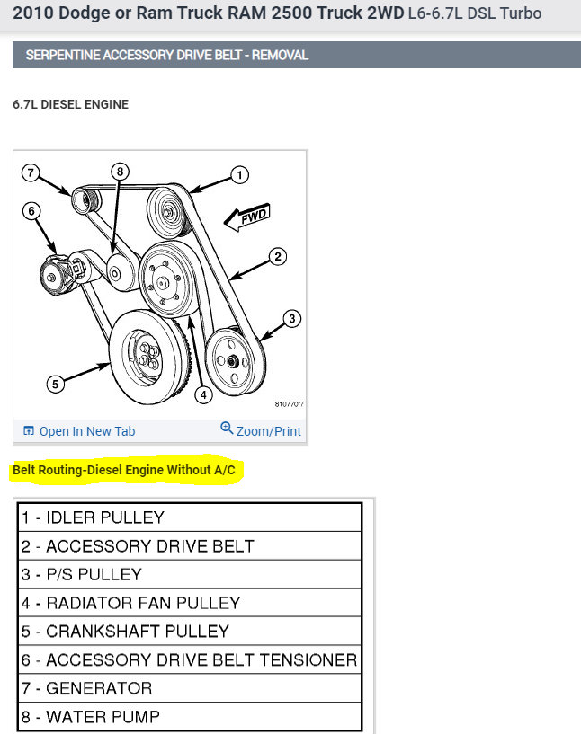

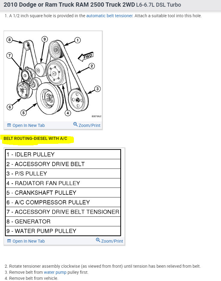

I need a diagram to put my new serpentine belt on. Itt’s a rear wheel drive, 2500 Diesel 2.7 and a 2010 it’s a heavy duty.
Saturday, June 25th, 2022 AT 4:07 AM
SQM
MECHANIC
6,383 POSTS

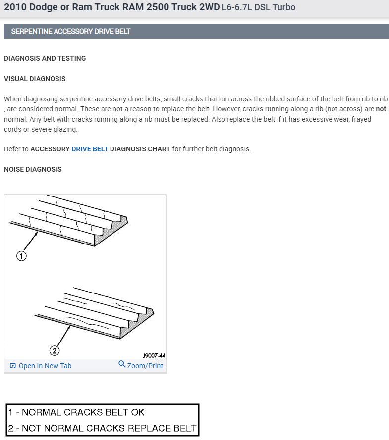

Please note that the Ram for that year came with a 6.7L diesel (not 2.7L).
I have attached the belt diagram and procedure below for your reference.
Let me know of any questions.
