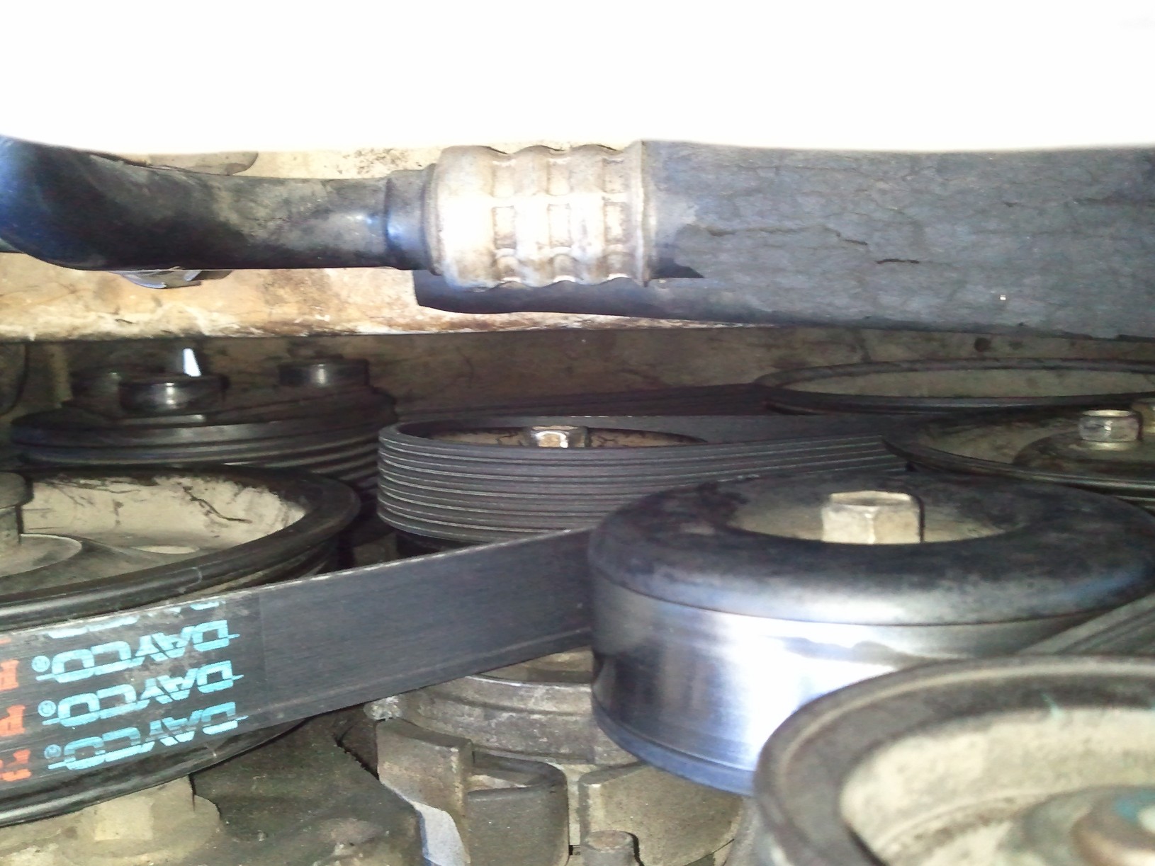

CARADIODOC
  • 34,465 POSTS
Yup. If a serpentine belt is off by 1/16", it has to slide across the pulley as it goes around it. Look for a worn bearing in the tensioner pulley. I can see the tensioner is worn out and needs replacement.

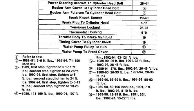

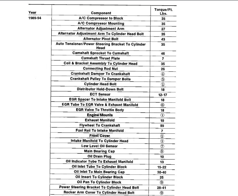

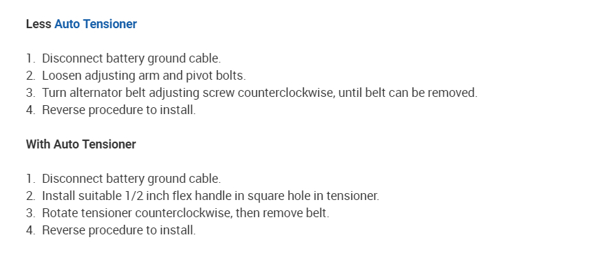

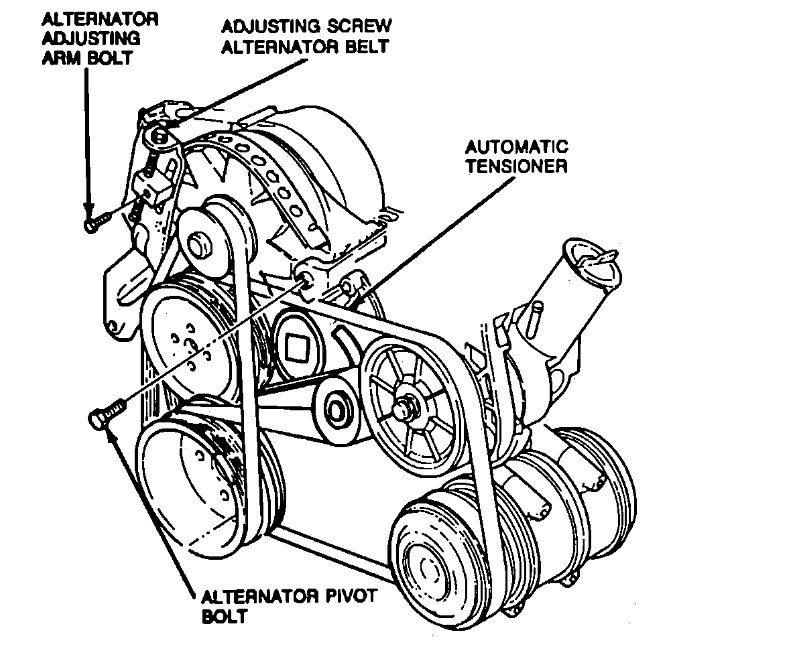

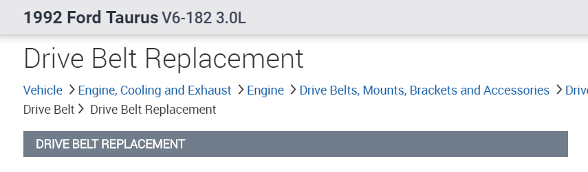

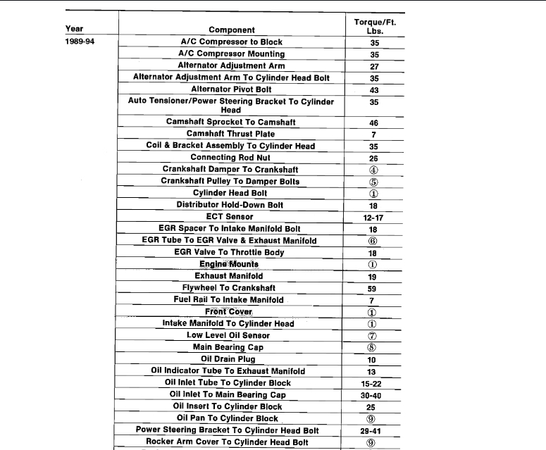

SCGRANTURISMO
  • 4,897 POSTS
This is probably a problem with your serpentine belt tensioner. I have a Ford Mustang GT 4.6L with a Vortech V1 supercharger and my engine is very susceptible to the belt shredding since the serpentine belt also turns the supercharger. What happens is the tensioner checks bent or the internal spring gets weak and the belt will loose tension, partially come off, and shred. On my vehicle it happens at higher RPM's. Replace the serpentine belt tensioner, per instructions in the documents below and get back to us with how everything turns out.
Thanks,
Alex
2CarPros
+1
