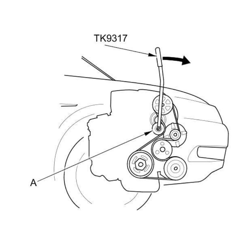

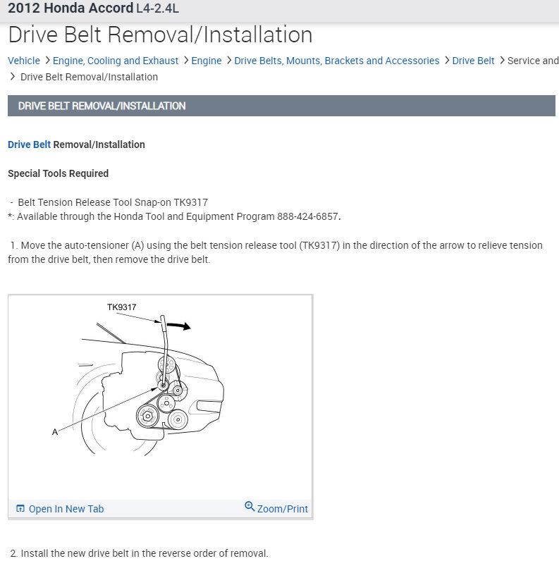

I need how tit goes back together. Can I get the installation diagram?

See attached for the serpentine belt diagram and the replacement procedure.
Let me know of any questions.

Thank you so much.
