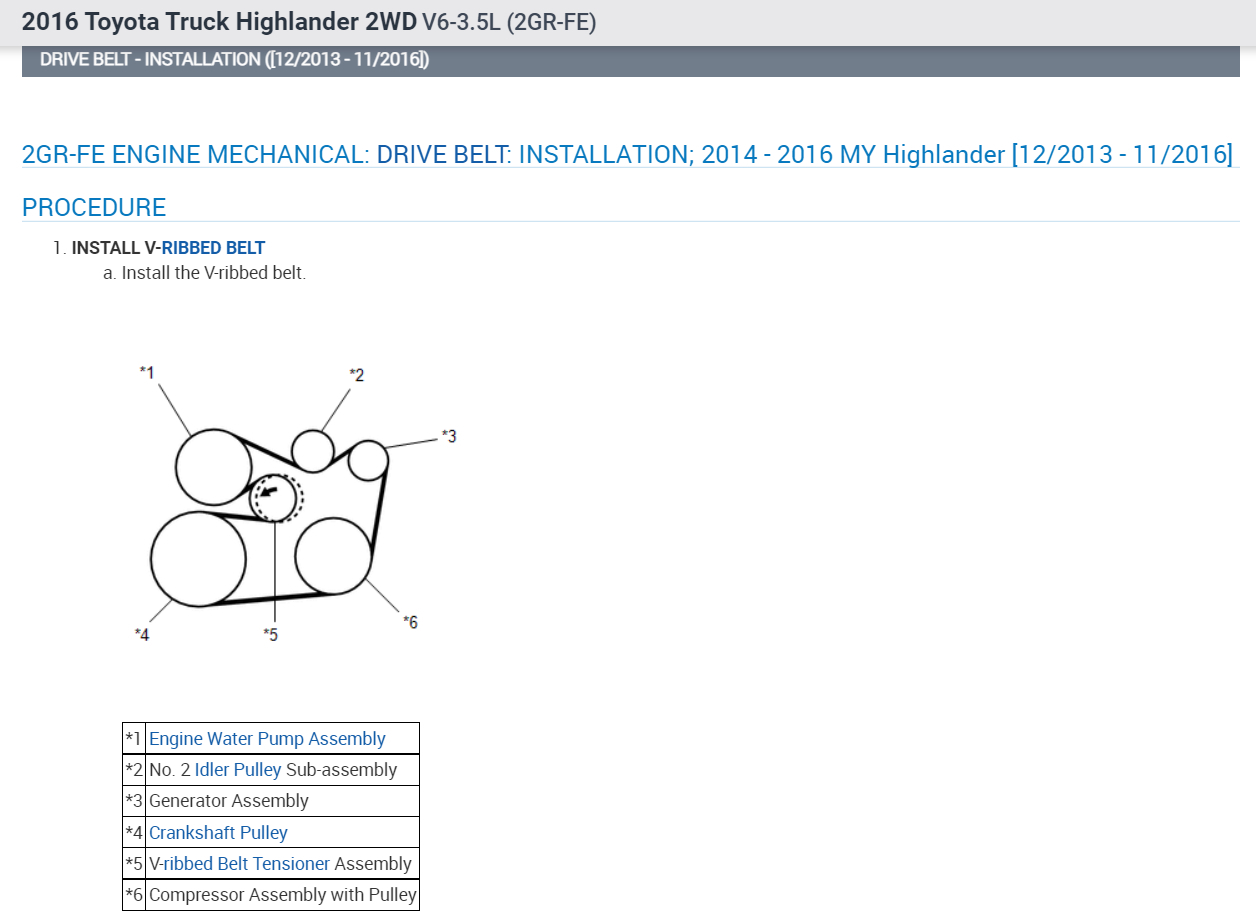

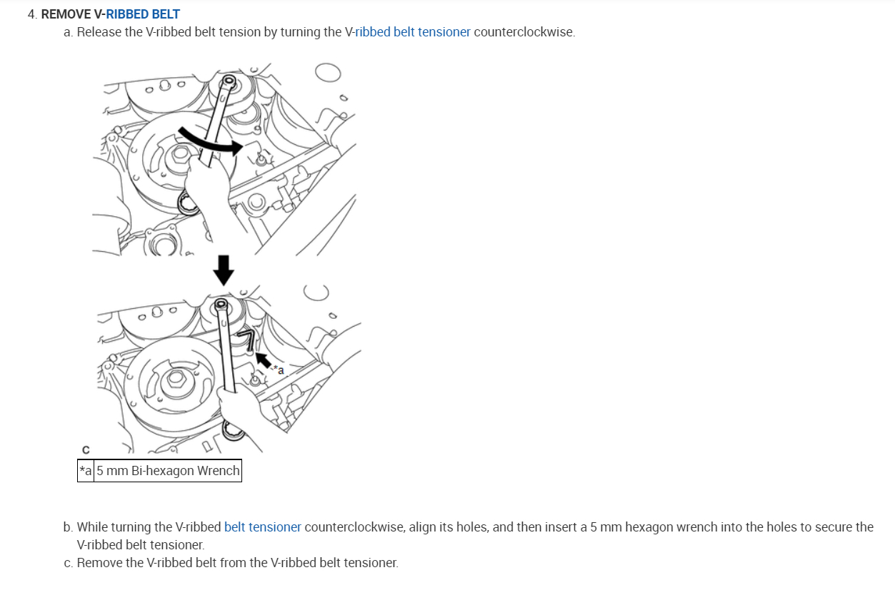

Looking for the serpentine belt diagram for this vehicle.
Oct 2, 2022 at 12:20 PM
  • CAR REPAIR CONTRIBUTOR
  • 54,415 POSTS

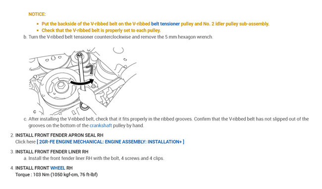

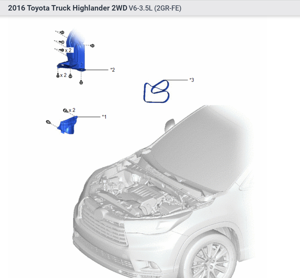

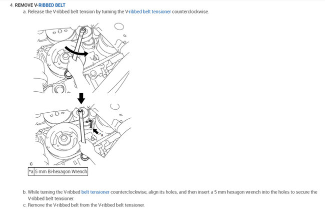

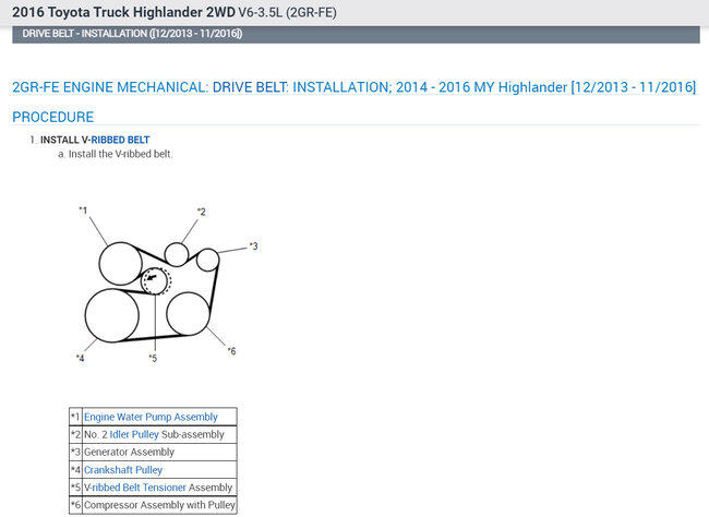

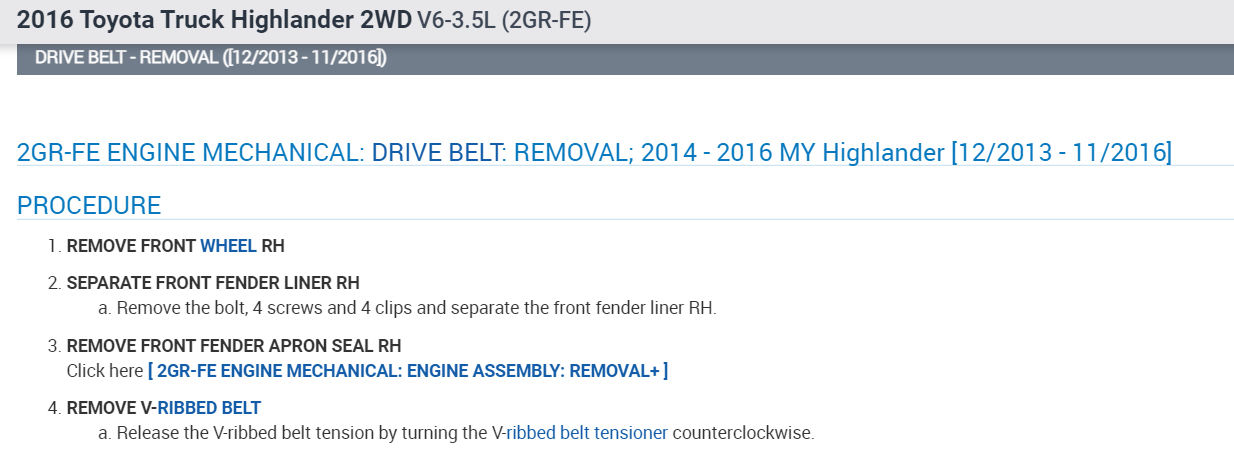

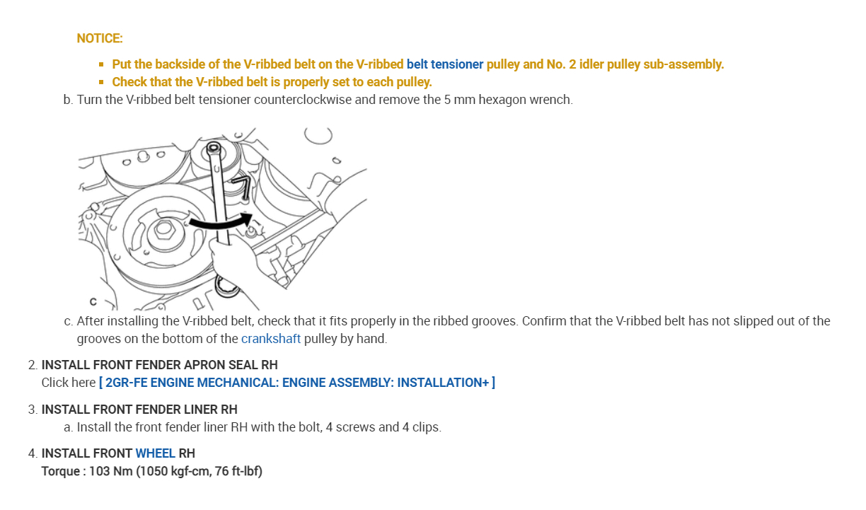

Here are the instructions and belt diagrams to help you change the serpentine belt out. Check out the images (below). Please let us know if you need anything else to get the problem fixed.
