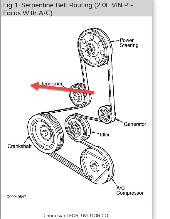

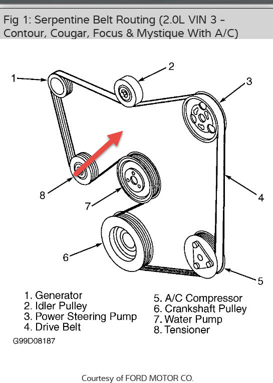

Serpentine belt
SHARON YOUNG2
  • 2001 FORD FOCUS
  • 4 CYL
  • FWD
  • 164,000 MILES
What tool do you need to put the serpentine belt on?
Friday, April 14th, 2017 AT 3:46 PM
HMAC300
  • 48,600 POSTS
Just wrenches that are metric, like a socket. There are two different diagrams on is VIN number P other is VIN number three both are shown move tension-er in direction of arrow to remove and install. Tension-er should be replaced as well.
