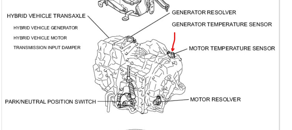

Sensor/ Wiring harness connector location, P0A2d Code?
2014 TOYOTA AVALON HYBRID
250,000 MILES • 2.5L • 4 CYL • 2WD • AUTOMATIC
MOHMINKHAN
Im having a P0A2d Code, and Im trying to find the 3 pin connector, but I cant find it, im looking near the firewall on the transaxle side, but i cannot find it, i would really appreciate if we can have a diagram like this to show the exact position
Dec 26, 2025 at 11:22 AM
MOHMINKHAN
A diagram like this would really help, {this is a diagram for a Highlander}
Dec 26, 2025 at 11:23 AM

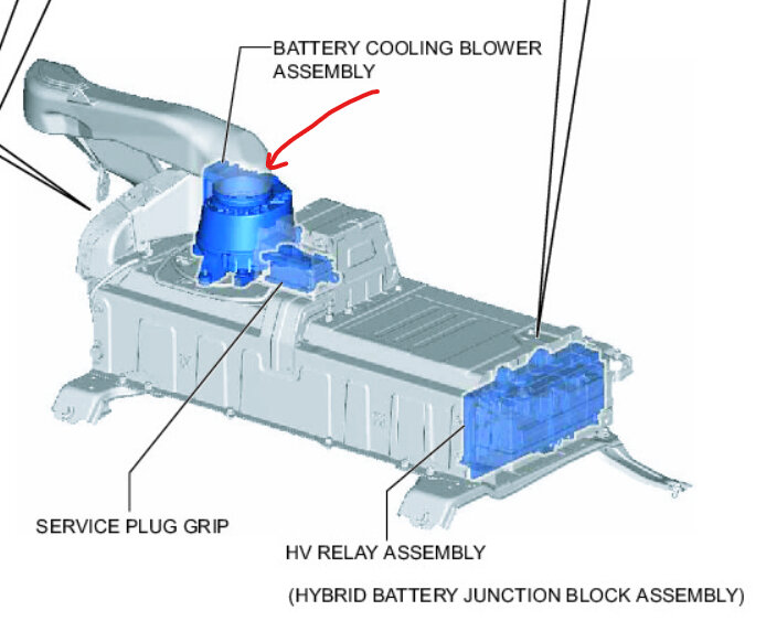

So there is misinformation out there that this is for the hybrid drive motor when in truth the problem is for the:
P0A2D - Hybrid Battery Pack Cooling Fan 1 Control Circuit / Performance
So this mean the hybrid cooling fan is not working, I would make sure there is not pet hair etc. caught in the fan itself also check the BATT VL SRR fuse in the fuse panel under the hood on the right side, if it is good, replace the fan motor. Here is the location. Check out the images (below). Let us know how it goes
