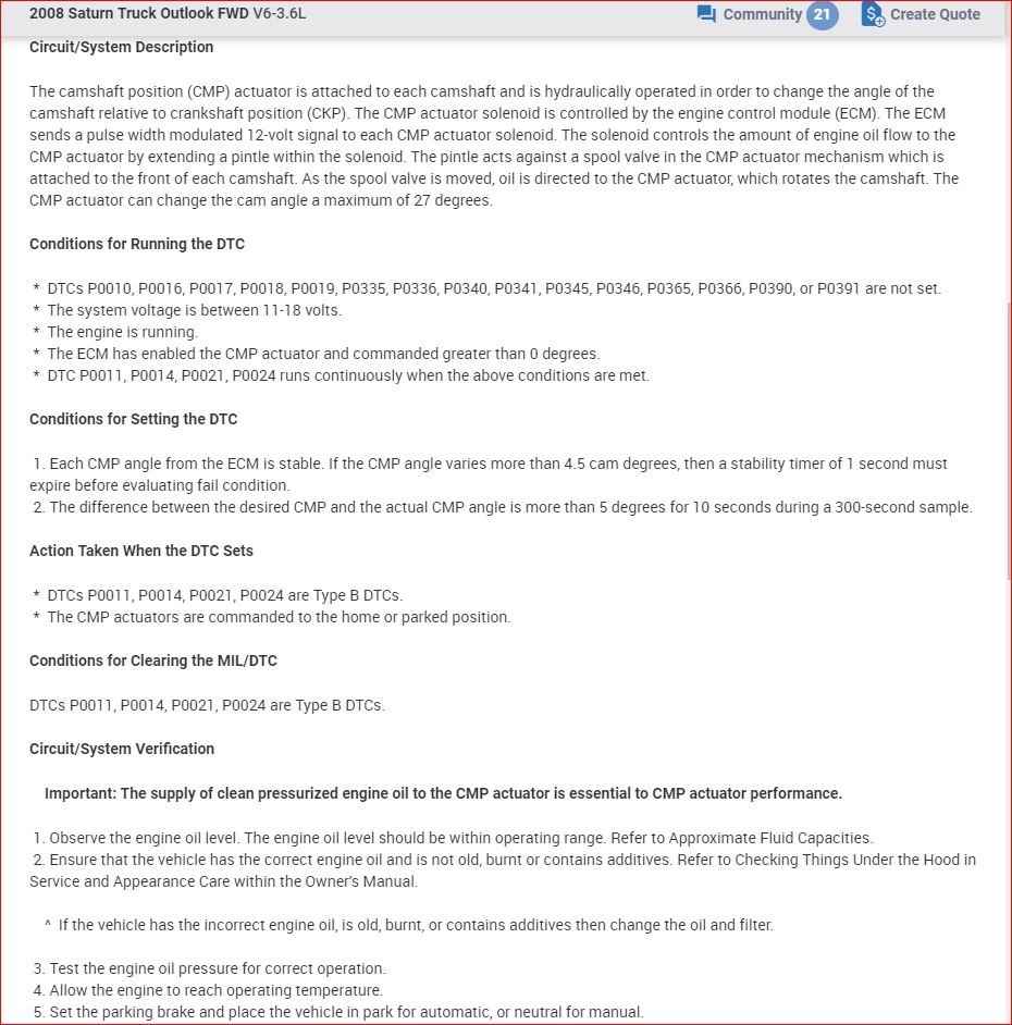

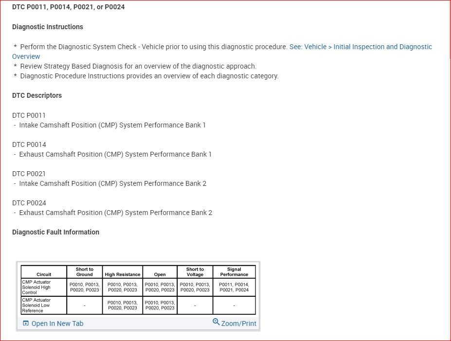

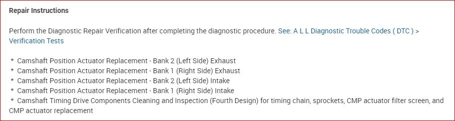

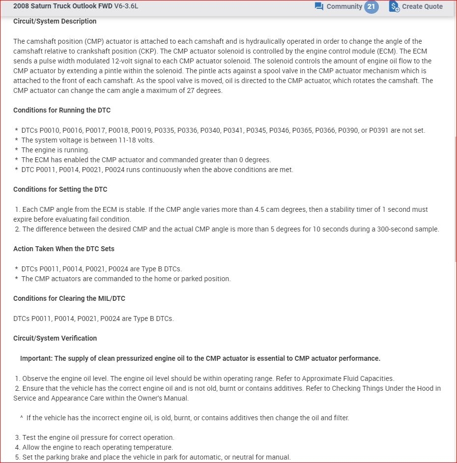

Recently starting getting these codes p0011, p0014, p0021, p0024 with stability track as well no engine reduced power. It is running sluggish with engine noise. got four sensors need help finding the locations.
Apr 30, 2019 at 12:53 PM
  • CAR REPAIR CONTRIBUTOR
Hi Sisco,

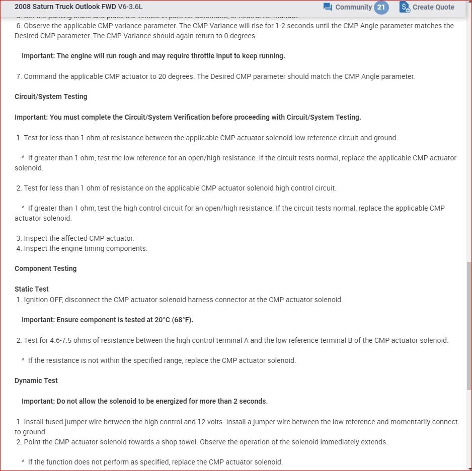

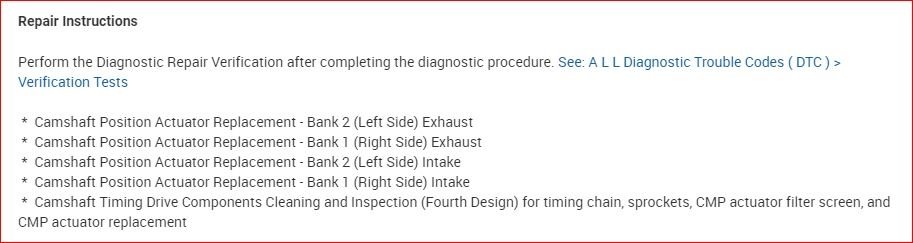

When is the last time your checked your oil or changed it? The fact that you are getting all four cam sensor codes is very unlikely that they are all bad. Incorrect oil or old oil or low oil will cause this. Also, the engine noise is concerning. I am wondering if you are low on oil and it is starting to knock.
Attached is the diag for these codes. Also the location. FYI. this is just a picture of one of them but this component is on the front of each cam shaft.
I would not suggest just replacing these as it is not a simple plug in sensor.
Give this info a read and let me know what questions you have and then tell me about the oil and we can go from there. Thanks

Well, I checked my oil and it was really low. I still had a 1/000 miles until next change and no signs of a leak.. I added two quarts and cleared the codes everything back to normal with no issues. I’m wondering how it got so low.

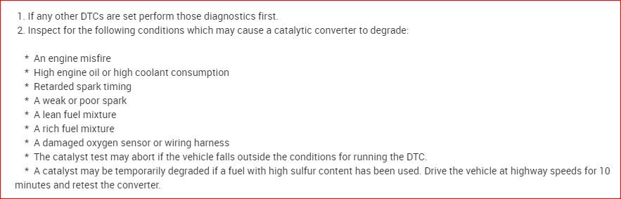

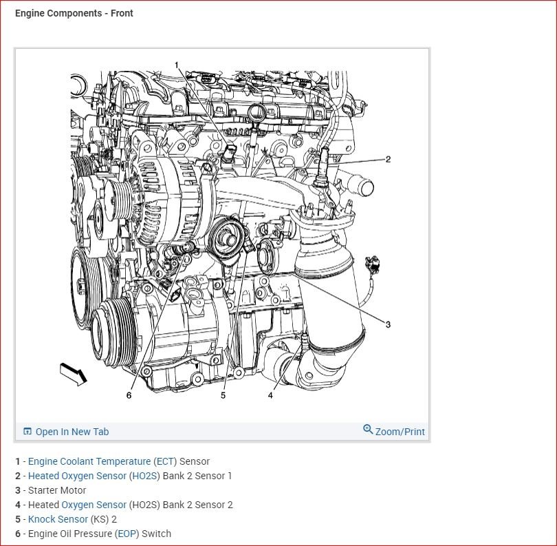

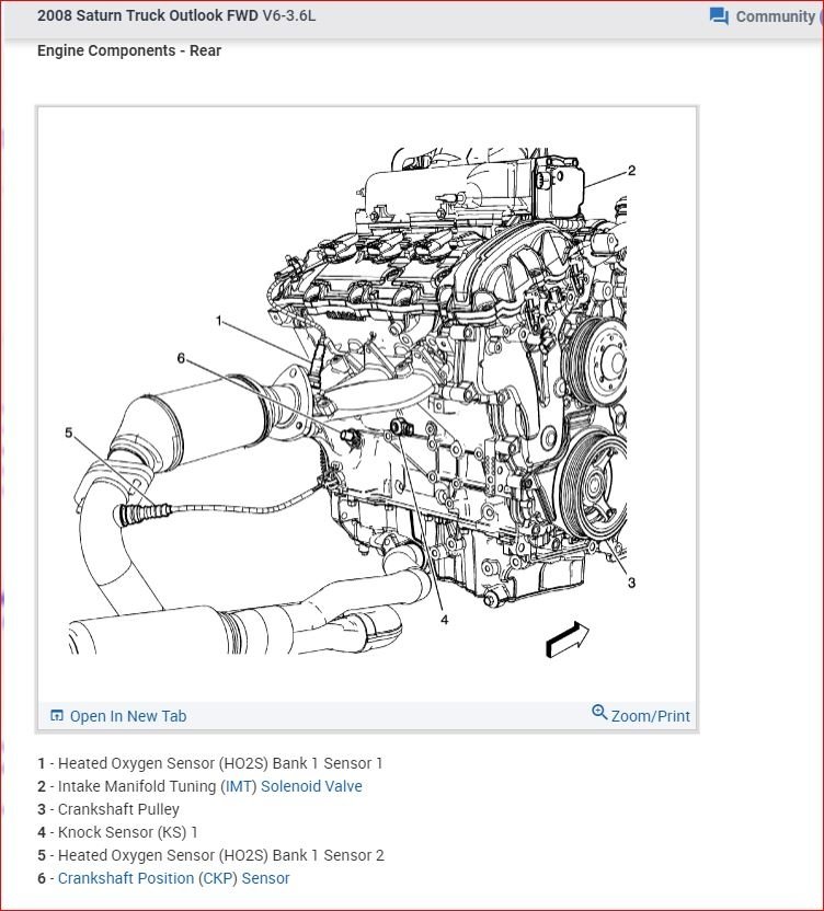

Ok the truck has been running well but I got a p0420 code last night is there any diagram showing where the o2 sensor is located
May 2, 2019 at 4:05 PM
I was a little concerned about this. This DTC says the catalytic converter is not performing as well as it should. It could be an o2 sensor that is contaminated by oil/soot but when an engine burns oil, it can damage the converter itself.
You have 4 sensors. One upstream (prior to the converter) on each side and then one down stream (past the converter) on each side.
This code is pointing to the Bank one side. This is detailed in the attachments.
I would suggest pulling them out and looking at them. You may find they are covered with oily residue and if they are, you want to replace them. Don't try to clean them because you can damage the components inside the sensor and it will not function properly.
