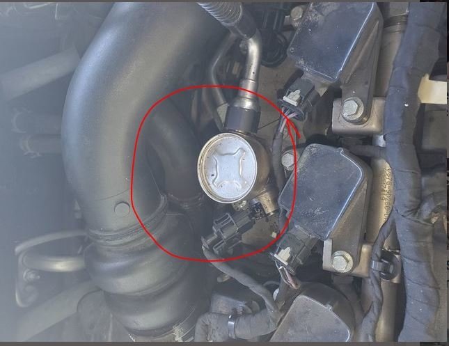

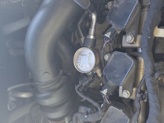

While replacing camshaft position sensor I appear to have knock something loose that appears to be a sensor with a clip connector. It sits to top of engine towards rear of car connected to a round metal piece.

That's a tough one without seeing it. Is it possible for you to upload a pic of the item in question? Also, let me know if it is a 1.5 turbo, the 2.0 turbo, or the 1.6 turbo.

1.5L EcoBoost turbo.
Sep 25, 2019 at 8:18 AM
  • 110,193 POSTS
Welcome back:
The silver item is a High Pressure Fuel Pump. I circled it in your pic. Let me know if that is the part you are referring to and what is loose?
Sep 25, 2019 at 6:08 PM
ADAM FELS
  • 5 POSTS
Thank you. that's what I was finding with further research. Can the solenoid be replaced inside it or will whole thing need to be replaced? Code showed fuel volume regulator control circuit.

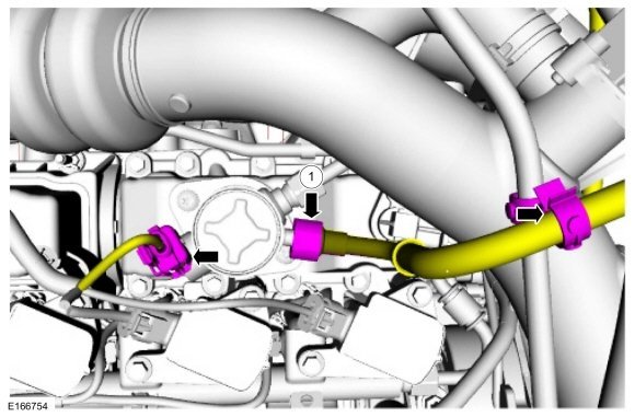

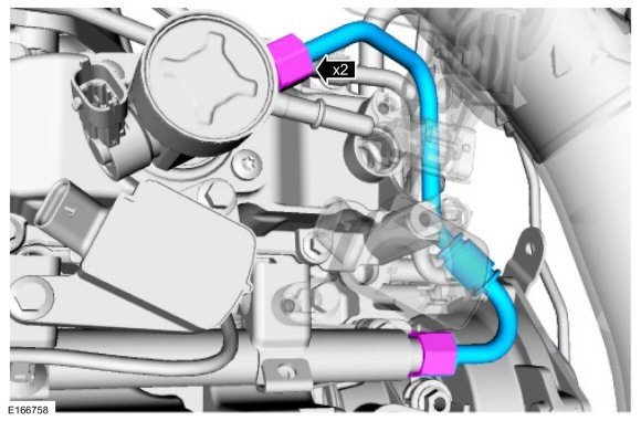

1. Refer to: Spring Lock Couplings See: Fuel Line Coupler > Procedures > Spring Lock Couplings (310-00A Fuel System - General Information - 1.5L EcoBoost (118kW/160PS), General Procedures).

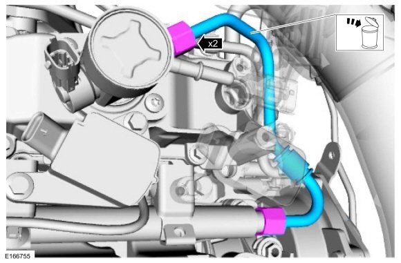

pic 2

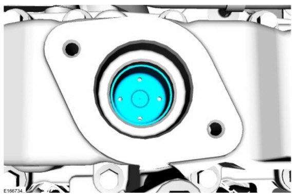

4. NOTICE: To release the fuel pressure in the high pressure fuel tube, wrap the high-pressure fuel pump flare nut with a shop towel to absorb any residual fuel pressure during the loosening of high-pressure fuel pump flare nut.
pic 3

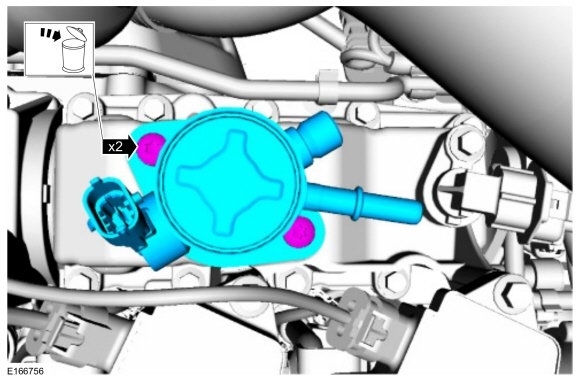

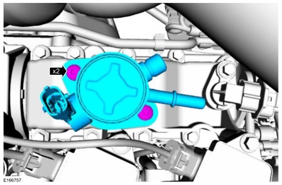

5. NOTE: Alternately loosen the 2 high-pressure fuel pump bolts one complete revolution at a time.
pic 4

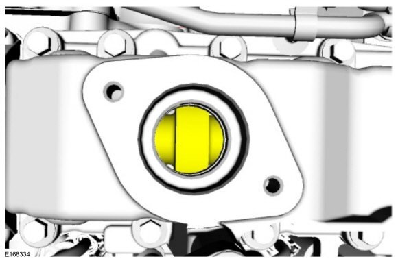

6.
pic 5

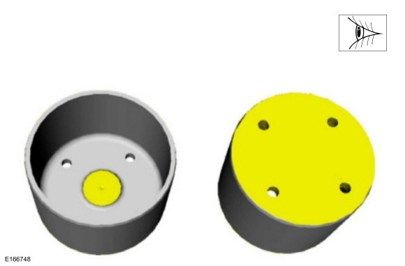

7. If any flat spots or scoring are found, especially in the indicated areas, then inspect the high-pressure fuel pump and the high-pressure fuel pump tappet drive lobe. Install new components as necessary.
pic 6

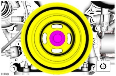

2. NOTICE: Only rotate the crankshaft Clockwise (CW) or damage to the engine may occur.
pic 8

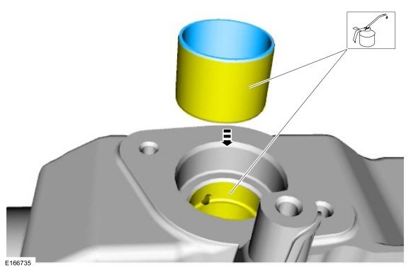

3. Material : Motorcraft(R) SAE 5W-20 Premium Synthetic Blend Motor Oil (U.S.)/ XO-5W20-QSP (U.S.) (WSS-M2C945-A)
pic 9

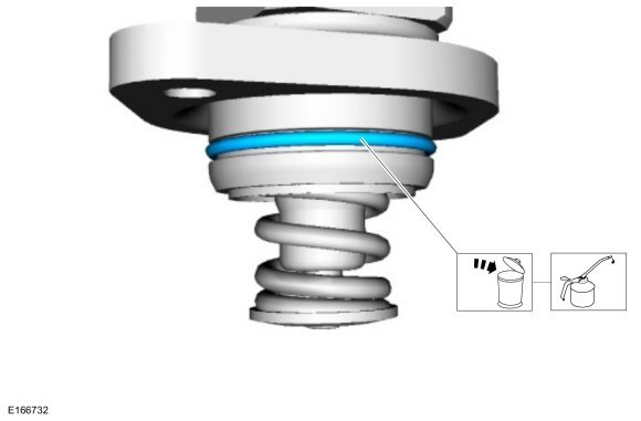

4. Make sure that a new high-pressure fuel pump O-ring is installed.
pic 10

So eventhough the connector in pic 13 is what broke off the whole thing has to be replaced?
Sep 25, 2019 at 6:29 PM
  • 110,193 POSTS
Welcome back:
Is it the connector on the pump or the connector on the wiring harness? If it is on the pump, I can't see how it could be replaced or repaired. It's a molded part.
Sep 25, 2019 at 6:55 PM
ADAM FELS
  • 5 POSTS
Connector on the pump. Wiring harness with female part to left of pump is fine.
Sep 25, 2019 at 7:10 PM
  • 110,193 POSTS
Welcome back:
Since it is on the pump, I would replace the unit. I can't see how it can be fixed safely, or even fixed at all. You don't want the chance of an electrical short at the high pressure fuel pump.
