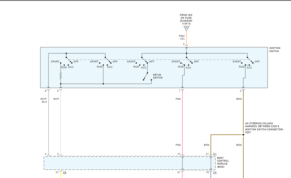

My car has two ON key positions not including the OFF position. I will note whether each wire is receiving power at each position.
White:
This wire is receiving power when the key is OFF. It only receives power when the key is in the ignition and in the OFF position. It is not receiving power when the key is in either ON position.
Brown:
This wire is not receiving power when the key is in the OFF position. It is receiving power when the key is in either the first or second ON positions.
Pink:
This wire is not receiving power when the key is in the OFF position. It is not receiving power when the key is in the first ON position. It is only receiving power when the key is in the second ON position.
I ran this test initially when my car was malfunction and unable to start. I now ran the test again when my car is able to start, and I got the same results. What are your thoughts on the results?

Sorry for the delay. Here is a wiring diagram so you can see what wire should be hot when. Check out the images (below). Let us know how it goes

I understand the diagram to say the following:
Brown should receive power only when the key is in the ACC and RUN positions.
For my car, brown receives power in these two positions but also when the key is in the START position.
Pink should receive power only when the key is in the RUN and START positions. This is accurate to my vehicle.
White should receive power when the key is in the OFF, RUN, and START positions.
For my car, white only receives power when the key is in the OFF position.
Could you confirm whether I am reading the diagram correctly?
Thursday, October 16th, 2025 AT 5:14 PM
KEN L
  • MASTER CERTIFIED MECHANIC
  • 55,291 POSTS
White should have power in the start and run position, it looks like the ignition switch is bad, you have found the issue.
