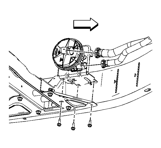

1st check the related fuses. If have a scan tool use it to turn the air pump on. The air pump and air pump relay are located on the driver side frame rail just bellow the drivers door. If that bi-directional communication is not available on your scan tool you can ground the brown wire on the air pump relay and turn the key on. This should turn the pump on if the relay is working the wiring to it is intact and the pump is in working order.
Now that the air pump is running open the air solenoid. You should hear a difference in the sound of the pump. Another way to verify it is opening is to unhook the fresh air pipe from the air cleaner assembly and feel for a vacuum when the solenoid is commanded on. If the valve is not opening try tapping on it when you command it open. If your scan tool does not support this option you can jump the relay in the under hood fuse box. However before removing the valve verify that you have power and ground when you are commanding the air solenoid open.
You may find that the supply pipe from the air pump to the valve is full of water. If this is the case make sure you blow out the lines before replacing any parts

Where is the secondary air injection pump on a 2005 chevy trailblazer and is it something I can replace on my own?
Monday, July 29th, 2019 AT 8:23 PM (Merged)
PROTECH1980
  • 901 POSTS
