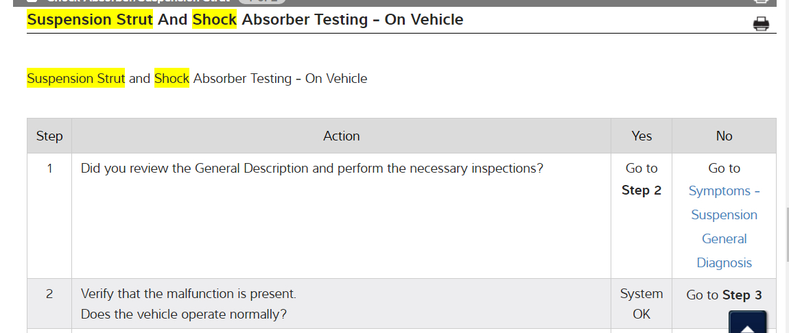

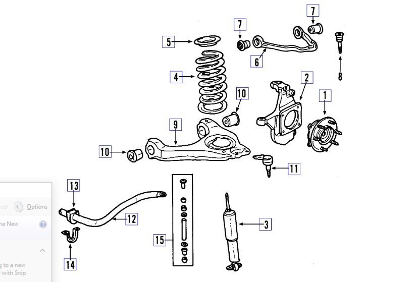

I drove into a pothole harder than I anticipated. Since that day my front right side has been making a rattling noise on every uneven stretch of road. Also I'm told when driving over a rough spot my right wheel appears loose or has play. Can you point me into a direction to start my attempt to save my ride? Please

Jack up the truck and look for anything loose or broken. Grab the wheel at three o'clock position and the nine o'clock position and move back and forth. Have someone look under or behind the wheel for any play.
Then hold it at 12 o'clock and 6 o'clock and move back and forth and look for any movement.
You may have broken a ball joint.

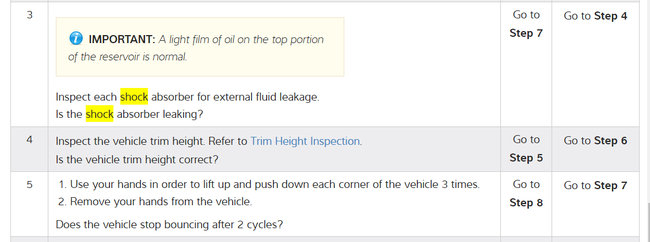

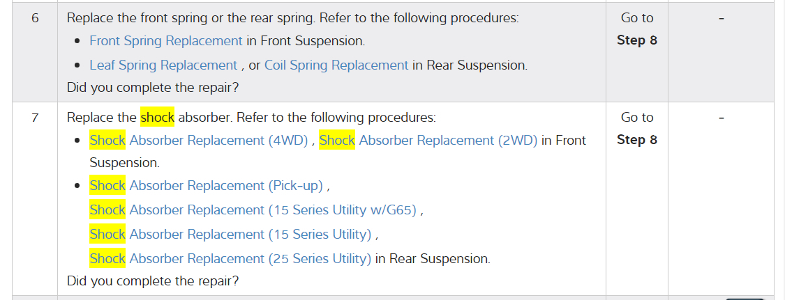

This could be a couple of things. Let's start by looking at the shock for the tire in question. In the diagrams down below I have included the factory guide for inspecting the shocks for your vehicle with them still on the vehicle. Please go through this guide and get back to us with what you are able to find out.
Thanks,
Alex

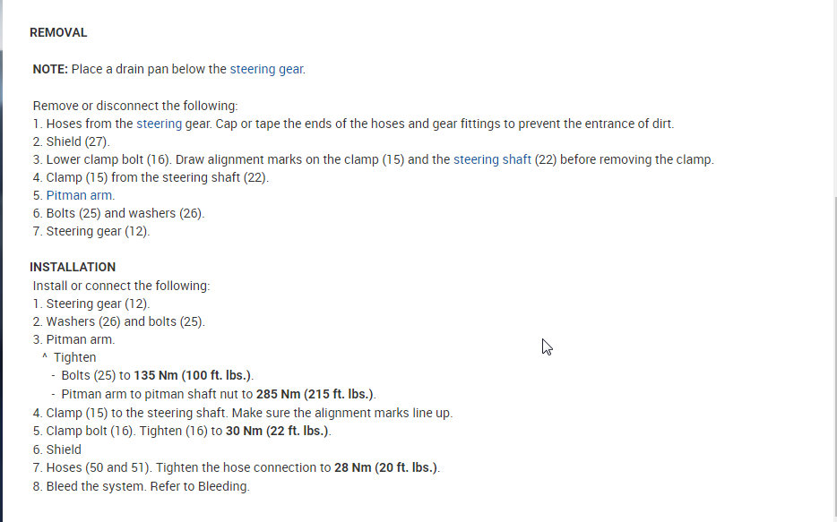

There was a leak in the gear box and the steering was super loose. So I got a new gearbox and installed it this weekend and now I am hearing a weird clanking or rattling noise when the truck is on in the same area as the gear box. I am somewhat of a novice and would appreciate any and all help! Also, I did change the outer and inner tie rods, pitman and idler arm too. The noise seems to go away in reverse but it louder in neutral. It also does seem like the switch between the gears in not as smooth as it was before I got under the truck this weekend.
Friday, May 14th, 2021 AT 11:24 AM (Merged)
I assume all you are doing is switching between park, drive, and reverse? If so and this is making this noise, I am sure something is loose.
What I would do is put the parking brake on and have someone sit in the vehicle and hold the brake while you lay down there to see if you can see anything vibrating. If not, then you will need to start grabbing the different steering components to see which makes it quieter.
I attached the process below and it says that there was a shield removed so we need to check this as well. Basically I would suggest going back over the repairs and make sure everything is tight but start with trying to isolate it.
