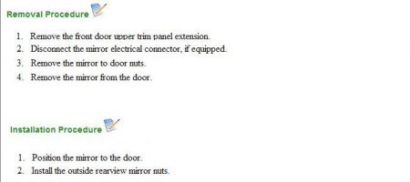

My friend was backing up with my Vue and broke the passenger mirror off on a trash can. It is now hanging on the side of the car, the mirror part is fine, it looks like the connector plastic stuff is busted. How can I fix this? Can I do it at home if I order a new mirror online? Thanks for the help!
