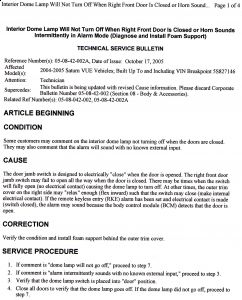

while driving, my doors keep locking and unlocking and the interior light comes on when this happens

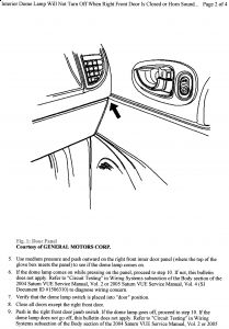

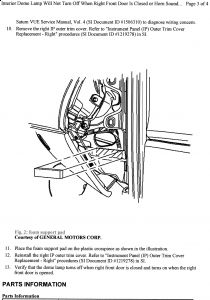

try this bulletine if ur door switch is triggering it will cycle ur locks and dome light.if u dont find anything with the bulletine then most likely u have a bad body control module and i would take it to the dealer for that because the new has to be programed.let me know what u find.
