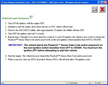

We had a diagnostic done and it said the anti theft was the problem so we changed the ignition switch and the lock cylinder (which was bad). It still won't start and the security dash light stays on for a while then goes off. Is there some sort of reset for the anti theft we're missing?

The new key will need to be coded to the car from the dealer before installation. If you did that then try this guide it will show you how to reset the system. https://www.2carpros.com/articles/how-to-reset-a-security-system and
https://images.2carpros.com/forum/automotive_pictures/416332_2003_vue_antitheft_1.jpg
Please run down this guide and report back Cheers

Didn't work could it be anything else besides the BCM?

I need to know what that code was you have so I know what direction to send you in because there is more left then just the bcm. I need the code number let me know.

Thanks for your help! My hubby fixed it by resetting the security from the guide it's running now! Thanks again!
