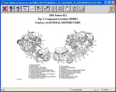

[img]https://www.2carpros.com/forum/automotive_pictures/416332_2001_coolant_temp_sensor_2.jpg[/img
ok if ur cooling works with the a/c then I would say u have a bAd coolant temp sensor there under 15 make sure u get a brass tipped one the plastic tipped ones crack.also check ur coolant temp sensor connector if it's corroded or green then replace it as well.becareful make sure the engine is cold u will loose coolant when u change it.if ur old sensor has a plastic tip see if it's cracked.that sensor controls ur temp gauge and turns ur fan on to cool the engine off at 222-226 degrees when they go bad they don't read the correct temp.in ur case it sounds like it turns the fan on then changes to a cooler temp within a few seconds turning the fan off again.let me know what u find.

Thanks for the info, can you tell me were is the sensor located their is one on the manifold can you tell me if that is the one? If not were can I find it.

Iam so sorry it took me so long to get back to u I never got a email telling me u replied. On my last post I posted a diagram showing where the sensor was. No it's not the one in ur intake. That's the inlet air temperture. The one u want is screwed into the head follow the upper radiator hose to the head the right bellow that screwed into the head is the sensor it has two wires going to it a yellow one and a black one. Make sure u check the connector too if it's corroded the replace the connector too it usually tens green when they corrod. Make sure u get a brass tipped sensor the plastic tipped ones crack. Let me know what u find. And again sorry it took me so long to get back to u if I would have known u replied I would have gotten back to u alot sooner.
