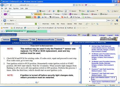

https://images.2carpros.com/forum/automotive_pictures/416332_2002_sl2_passlock_relearn_1.jpg
First of all thank you very much for your donation.I have posted the passlock relearn instructions for you please follow them and let me know if your car starts.

did that and still doing the same thing. when checking pulse on the injectors I get a light that is not pulsing. I changed the steering colum and took the old chip of the old colum to the new one, don't know if that made any difference. I think it is an injectors problem.

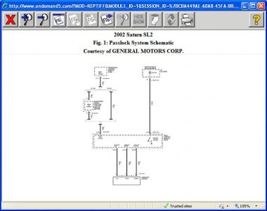

tried that and didn't work. The old engine was locked up ( throw a valve) was working fine befor that. When I tried to turn the ignition on for 10 min and rebeat that 3 time, on the first try the secuirty light will come on and stay on then it go out after 10 min. then if I try it again (the second time) it will go out after a couple of seconds, but it won't start. do u have a diagram for the secuirty and the injectors.

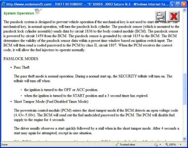

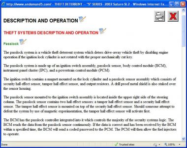

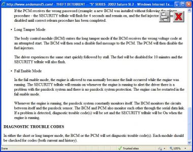

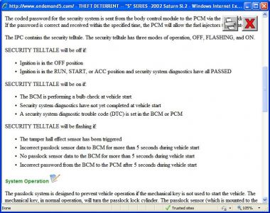

https://images.2carpros.com/forum/automotive_pictures/416332_2002_sl2_security_diagram_1.jpg
https://images.2carpros.com/forum/automotive_pictures/416332_2002_sl2_passlock_operation_part1_1.jpg
https://images.2carpros.com/forum/automotive_pictures/416332_2002_sl2_passlock_operation_part2_1.jpg
https://images.2carpros.com/forum/automotive_pictures/416332_2002_sl2_passlock_operation_part3_1.jpg
https://images.2carpros.com/forum/automotive_pictures/416332_2002_sl2_passlock_operation_part4_1.jpg
Here is the wire diagram for the security system and the security system operation explained.As you can read when the security system is engaged it shuts the injectors off thats why your car starts when you prime it.With your security light flashing this is what has to be happening explains everything you have decribed to me.Problem is we cant get the codes your car is setting so we can follow the trouble tree.The codes are stored in your body control module most scanners like the store bought ones dont read body codes.Also when you get the code you need that same scanner to read your passlock sensor voltage so you can trace the problem down.What i think might have happen is when you changed just the chip aka the passlock sensor you damaged it your suppose to just change the whole ignition housing not just the passlock sensor.When i say the whole ignition housing i mean where the ignition cylinder goes into and turns the ignition switch.Thats really the only thing that makes sense to me unless theres something you did when you changed everything i cant see.What you should have done when you changed the steering column was just have left that passlock sensor alone and used the igntion housing that came with the column.Then learned that new passlock.
