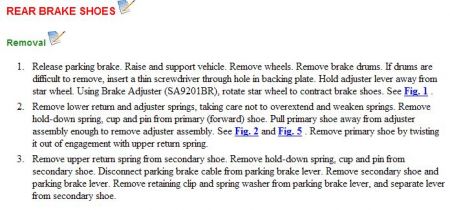

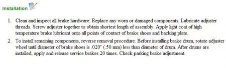

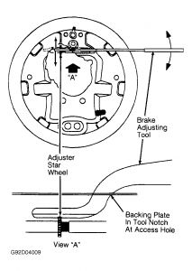

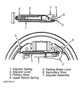

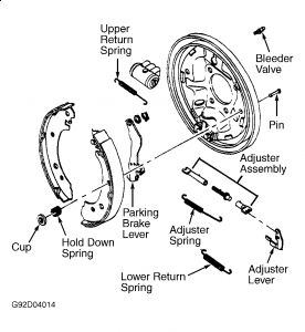

2000 Saturn SL2 Replace rear brake shoes
JERRY ELDRED
  • 2000 SATURN SL2
Brakes problem
2000 Saturn SL2 4 cyl Front Wheel Drive Manual
skematic on replacement
Sunday, February 7th, 2010 AT 2:41 PM
BLUELIGHTNIN6
  • 16,542 POSTS
https://www.2carpros.com/forum/automotive_pictures/261618_Noname_1592.jpg
FIG. 1
https://www.2carpros.com/forum/automotive_pictures/261618_1_110.jpg
FIG. 2
https://www.2carpros.com/forum/automotive_pictures/261618_2_85.jpg
FIG. 5
https://www.2carpros.com/forum/automotive_pictures/261618_5_6.jpg
https://www.2carpros.com/forum/automotive_pictures/261618_Noname2_486.jpg
