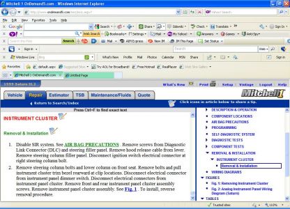

The light on the odometer is not working. All other instrument lights are normal. The owner's manual calls out a lamp for this.
How do you gain access and replace the lamp for the odometer?

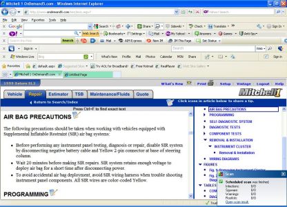

First of all thank you so much for your donation.Theres the information on how to remove the cluster.There are no screws holding the cluster bezel though its held in place by push clips.If you push the center of the clip in till it clicks then you can pop the clips out with a small screwdriver.Also it doesnt tell you that you have to remove the dash top to get acess to unplug the cluster and get to the rear cluster screws.To remove the dash top you will see two screw covers in the center of the dash pop the covers off then remove the screws.Now you will have to get a good size flat bladed scewdriver and find each clip on the edge of the dash and pop each one up.Once you do that you can slide the dash top out but becarefull not to get hooked up on your vin plate on the driverside by the windshield.Once you get the cluster out you can look behind it and figure out which blub lights up the odometer so you can replace it.Let me know if you have anymore questions.Thanks again for your donation and for using 2carpros.
