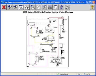

https://www.2carpros.com/forum/automotive_pictures/416332_98sl2_starter_diagram2_2.jpg
ok lets see if its ur alarm keeping the starter from working.look at the diagram i posted go to the starter relay under the driverside of the dash down the steering column.check for a ground at terminal a1 if u have a ground there its not ur alarm causing the starter to be inop.if there isnt a ground there then try this.put ur key in the acc postion for 45mins see if it starts.let me know what u find.
Wednesday, January 8th, 2020 AT 10:41 AM
FOTOBOY
Sorry, but the diagram is too small to read, even when I enlarged it, got nothing reasonable from it.

SATURNTECH9
  • 30,869 POSTS
Ok private message me ur email address and I'll email u that diagram. Did u check the ground for starter relay?Let me know.
