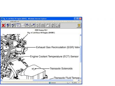

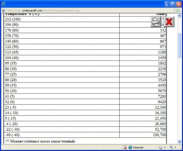

https://www.2carpros.com/forum/automotive_pictures/416332_1998_sl2_coolant_temp_sensor_ohms_chart_2.jpg
https://www.2carpros.com/forum/automotive_pictures/416332_1998_SL2_coolant_temp_sensor_location_1.jpg
The coolant temp sensor's on those car's go bad a lot and cause all kind's of problem's.I suspect yours could be bad as well.There only 10 if you replace it make sure you get a brass tipped one the plastic tipped one's crack.If you want to test it first i posted the ohm's value chart for it you would take a ohm's meter when it was cold and you knew what the outside temp was then see what the ohm's value was compared to the chart and see if it was reading the correct temp.Also check the connector going to it if it's corroded they usually turn green then you would have to replace the connector also.To unplug the connector you have to squeeze the connector.But i will leave if you want to check it or just replace it up to you.I would like if you check it first so you don't replace it for no reason but that's up to you.Let me know what you find.
Thursday, September 9th, 2010 AT 12:19 PM
SIMMBASS
I'm happy to report changing the coolant temperature sensor worked.
