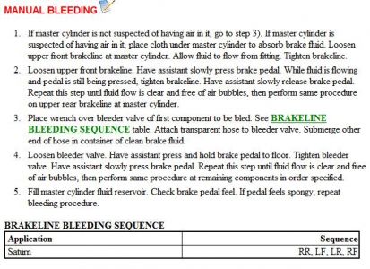

Brakes problem
1997 Saturn SL2 4 cyl Front Wheel Drive Automatic
how to adjust rear drum brakes? And get correct bleed?
Monday, July 5th, 2010 AT 7:52 PM
RICHZOMBIE
MECHANIC
173 POSTS
Monday, July 5th, 2010 AT 7:54 PM
