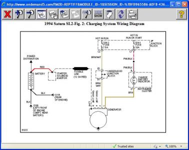

https://images.2carpros.com/forum/automotive_pictures/416332_1994_sl2_alternator_wire_diagram_part1_1.jpg
First of all thank you so much for your donation.It sound's like you have a another bad alternator.But let's check a few thing's with the car idling what is the voltage at the battery cable?Also you should have battery voltage to the stud the fuse link goes too.Also on the connector to the alternator you want battery voltage going to the brown and white wire if you have those two things and the alternator is spinning then you should be charging.Let me know what you find.

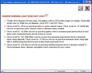

Yeah looks like your going to be changing it out again.As far as new compared to rebuilt i would just stick with the rebuilt where did you get your alternator from?You did very well with your first alternator i used to replace them all the time under warranty when the cars were still under warranty they were a piece of junk till saturn came out with there rebuilt ones and they were better then the new one's lol.They even had a better warranty the new one's that we sold had a 12,000 mile or 12 month warranty and the rebuilt one's were 3 year or 36,000 mile warranty if we installed them at the saturn dealer.I posted the trouble tree for battery light inop for you.
https://images.2carpros.com/forum/automotive_pictures/416332_1994_sl2_battery_light_inop_1.jpg
