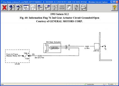

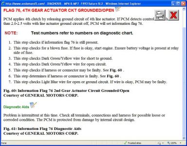

  • 30,870 POSTS

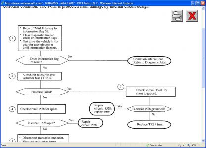

https://www.2carpros.com/forum/automotive_pictures/416332_1993_sl2_4th_gear_circuit_1.jpg
https://www.2carpros.com/forum/automotive_pictures/416332_1993_sl2_transmission_wire_diagram_1.jpg
https://www.2carpros.com/forum/automotive_pictures/416332_1993_sl2_code_76_part_1_1.jpg
https://www.2carpros.com/forum/automotive_pictures/416332_1993_sl2_code_76_part_2_1.jpg
https://www.2carpros.com/forum/automotive_pictures/416332_1993_sl2_code_76_part_3_1.jpg

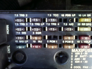

take ur metter put it on dc 20 start ur car let it idle take and put postive red to red on the car battery and black to black on the battery let me know what ur voltage is at idle on the car idling.then start with checking the underhood fuses all of the fuses starting with trslp trs2 trs3 trs4 and tcc fuses u will have to remove them and check them visually u will be able to see if there blown.do this with the key off.check all the other fuses key on engine off.with ur metter on dc 20 ground the black lead to the battery black post take red lead and test each side of the fuse it should read battery voltage on each side.let me know if any dont and if they dont then turn the key off and pull the fuse and visually check the fuse to see if its blown.i posted the trouble tree for code 76 thats the trouble tree we will start with u always start with electricial codes the other ones 22 23 24 are both mechainicial and electricial.as u can see on code 76 it asks u to start with clearing the codes with a scan tool and see if they reset to see if there current codes or interminatant codes which we cant do we dont have a scan tool to do that.also if we had a good scan tool we code buzz all the actuators for the gears that have codes thru the pcm and see if we have any problems there also.check what i asked so far i will do my best to help u figure this problem out.but no promises to if i can help u all the way thru due to lack of saturn scan tool with all the special tests and other special tools that i usually use and it could be a intermintant problem meaning when we do the tests they could pass but still be bad intermintantly which makes things alot more difficult to diagnose.but i will help u thru this the best i can.let me know what u find and we will go from there.

Battery voltage was 14.20. the fuse 10 B/U LP had a number 15 fuse so I put on the number 10 fuse. The 7.5 trs4 was blown so I replaced it with another 7.5 fuse. The 10 LH had a number 20 so I replaced it with a number 10. The 15 FOG LP is missing. All fuses passed the battery test with the exception of the 7.5 TRS 2, 3, 4, TCC, LP and the fuse between the TCC and TRS 2. Also the larger fuses to the right were not blowned and passed the battery test. (the problem continues).

https://www.2carpros.com/forum/automotive_pictures/516745_0415101328a_1.jpg

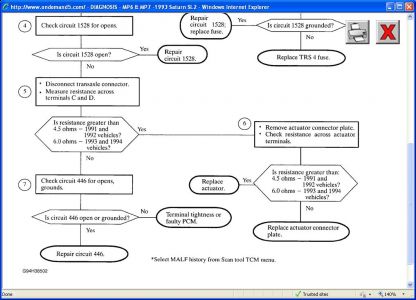

  • 30,870 POSTS
Yeah non of the trans fuses will have power until the pcm comands power to them thats why I asked u to visually check them. Did the trs 4 fuse blow again?Did u check circuit 1528 to see if its grounded?To check that u would unscrew ur transmission connector the square one on top of ur valve body cover below the battery remove the connector. Put ur meter on 200 ohms scale put black lead to ground and ur red lead to terminal c of the connector the back of the connector is label with letters.U should have no readings to ground just like if the meter wasnt hooked up. Also while u have the connector off with meter on the same scale put it across the terminals on the valve body not the connector starting with g to f- j to h- a to b -e to k it should read around 6 ohms between each terminal use the back of the connector to guide u to which letter pins u need. Let me know what the readings are for each set of pins. Also non of the other fuses for the transmission wernt blown u checked them all visually?Let me know.

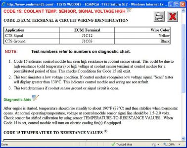

  • 30,870 POSTS

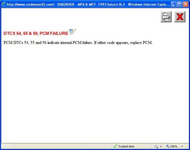

https://www.2carpros.com/forum/automotive_pictures/416332_1993_sl2_code_15_1.jpg
https://www.2carpros.com/forum/automotive_pictures/416332_1993_sl2_code_55_1.jpg
https://www.2carpros.com/forum/automotive_pictures/416332_coolant_temp_sensor_19911995_5.jpg
wow what a mess u have that was a big gamble repalcing the transmission like u did.what yr and model car did the transmission come from u got the transmission from?as far as ur codes go starting with ur transmission codes 14-low line pressure69-line pressure actuator shorted to voltage.68-line pressure actuator circuit grounded or open.65-battery voltage too high.55 pcm failure which i posted what it says about that code in the manual.43-enable master relay grounded or open.42-noise on vechile speed sensor.41-vechile speed sensor input not present.26-tcc stuck on.24-no fourth gear.21-2nd gear stuck on.22-no 2nd gear.23-no 3rd gear.24-no 4th gear.now to engine codes.51-faulty prom/mem cal.15-ecm terminal circuit identiy factor which i posted what the manual says about it make sure ur coolant temp sensor wires arent pinched between the engine and transmission bell houslng which is possibly to do.also make sure all the other pires didnt get cut or pinched.looks like from ur codes u have a bad pcm which doesnt mean it will fix all ur codes but there are codes for bad pcm.what i like to do when i have a code for a bad pcm is to clear the codes and see if the bad psm code comes back if it does then replace the pcm makes me feel better about replacing it.whats scarey though in ur case is u didnt have all these bad pcm codes before u changed ur transmission.and u have almost all new codes and new ones u didnt have before u changed ur transmission.the best way to go with ur pcm would probably be used cheaper and u might avoid havubg to program it.if u went new u would for sure have to have it programed.u can use 93 or 94 twin cam automatic pcms there the same part numbers.they have alot of them on ebay u just put in saturn pcm or ecm and search thru them all.i just checked autozone and kragen looks like its not available new in aftermarket.the dealer one new is 542.00 so looks like used on that one.if memorey serves correct if go with the used pcm then if ur car had cruise control and the car the pcm came from didnt then ur cruise wont work until u have that turned on at the dealer.let me know what u find.

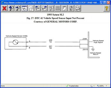

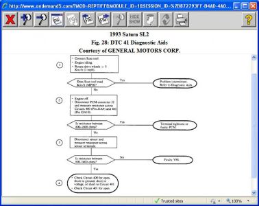

I changed the PCM with a maching atomatic 1993 transmission and its running smoothere, now my question is with code 41-vechile speed sensor input not present. What sensor is it refering to? Autozone told me that there are two sensors. Vihicle speed sensor, and transmission speed sensor.
+1
Tuesday, May 11th, 2010 AT 6:45 PM
SATURNTECH9
  • 30,870 POSTS
https://www.2carpros.com/forum/automotive_pictures/416332_1993_sl2_speed_sensor_wire_diagram_1.jpg
https://www.2carpros.com/forum/automotive_pictures/416332_1993_sl2_code_41_trouble_tree_1.jpg
https://www.2carpros.com/forum/automotive_pictures/416332_1993_sl2_speed_sensor_1.jpg
glad to hear ur down to one code now the sensor ur looking for is number 36 on the pic i posted.the other sensor autozone was talking about is the input speed sensor its by transmission filter.differnt code for that though.i also posted a wire diagram for the speed sensor and a code 41 trouble tree for u.let me know what u find.
